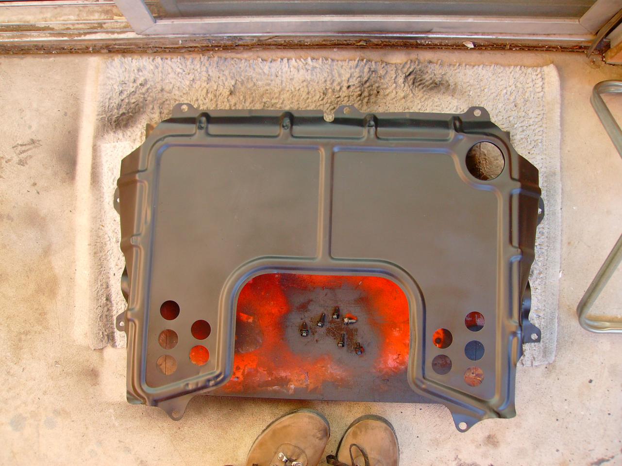

This past weekend I finished up the skid plate on my car. Ended up painting it a nice flat black color. Sprayed it with two coats of flat black. May put down one more coat before I reinstall it.

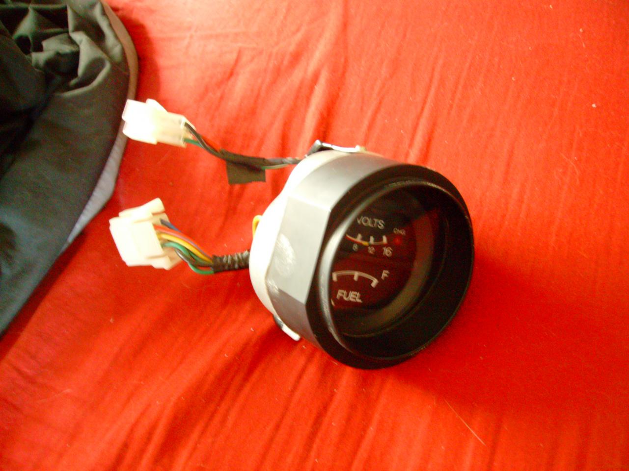

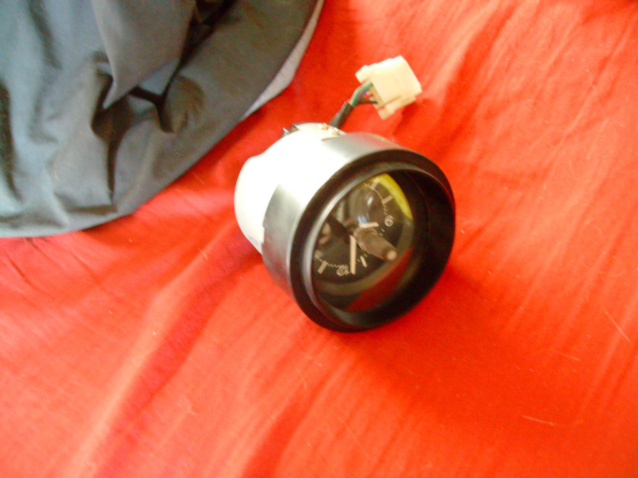

Next project on the list is the interior. Plan on getting the clock working and replacing the volt/fuel gauge. I picked up the two gauges at the local u pull yard in Tucson. Was amazed that they were still there.

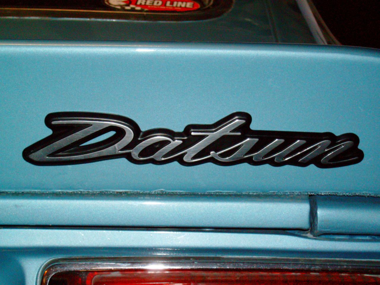

This past weekend I went to the local junkyard and found, to my amazement, a 76 280z 2+2. Wasn't at all in very good shape but it did have a rear "Datsun" badge that I desperately needed. I pulled that off along with a number of other odds and ends. Brought the badge home and mounted it on my rear "wing". I think it looks pretty awesome.
