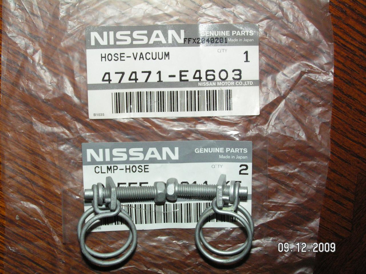

The hose from the check valve to the intake is easy to find........the check valve is easy to find...........the master vac to the intake is tough.........the Nissan part number for this is:
47471-E4603
I just replaced my entire master vac system this week with both hoses - clamps - master vac - check valve. There are still metal check valves out there, don't settle for a plastic one if you can help it. I think it cost me about $40.00.
The clamp part number is:
01555-00211-KT they were 1.93 each - the kit code consists of 2 clamps per package
