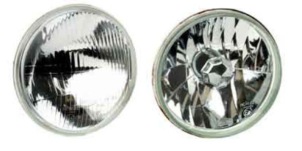

also can any one tell me the different between the smooth reflector type compared to the ones with the little flats in it, pic included

5 3/4" from memory.. narva do a main beam conversion set part number 72050 (with high and low, as well as a parker light).. they also do a set of the smooth reflector ones which i believe are high beams (72060).

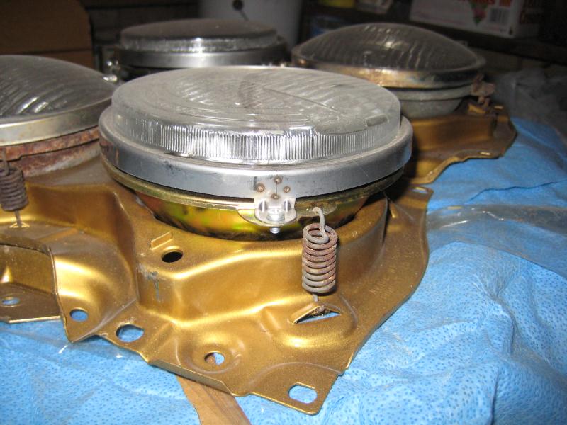

one i prepared earlier, i actually bought 2 sets (only 1 installed at the moment) so that i could do both high/low beam and the high beam
they look very similar (other than the different reflector design). I am pretty sure i had to order in a set of the dishes that the lights sit in from Narva (you can see they are gold rather than corroded).. can't remember why i didn't use the standard ones.. but i remember having to order them (it was over 4 years ago now)
yep, just checked, page 35 of their online catalogue shows part 72186, which is the mounting housing for 5 3/4".. you could probably modify the standard one though.. i didn't try
