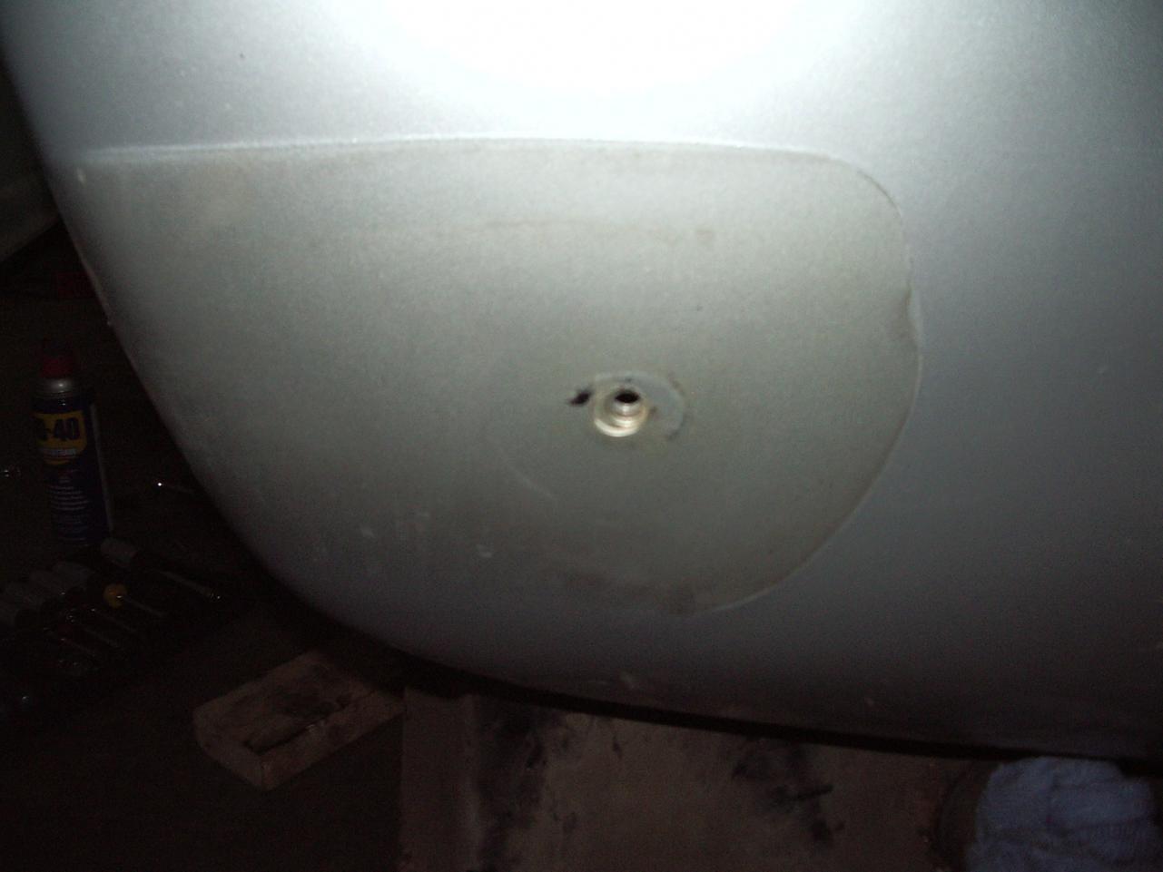

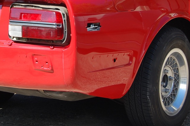

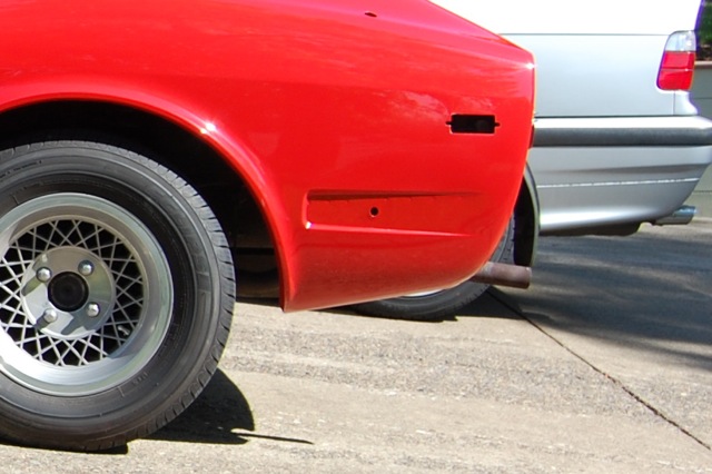

They do bolt to the side, but farther forward than that. On a 240Z the hole is not threaded, and is about 10 1/2" from the rear. On the right side it is about even with the rear edge of the fuel door. The 240Z bumper has a threaded mounting tab on it, the bolt goes through from the inside of the fender into the bumper mount.
