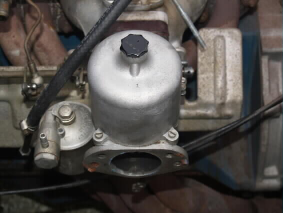

Was finally able to get to the shop and take a look, they had four screws holding the domes...On the questions about the VIN and manufacture date, the VIN is HLS3018078 the manufacture date is 12/70...I spoke to the guy that is working to repair the carbs he explained that the gaskets, and the replacement valve (?) did not fit...while he is not a Z guru, he is recognized by many as knowing what he is doing with carbs...

Ok some more questions for you...on my car the float body comes off the left side on both the front and rear carbs...I looked at the spotter images on ztherapy and they show the float body on the left side of the front carb and on the right side for the rear carb...I will try to post photos but they are rather large so ...
Thanks Tony
Datsun roadster carbs have the floats on the left side but those don't look like roadster carbs. Maybe they're British SUs but they don't appear to be 240Z carbs.
Tony,
That is definitely NOT a Zcar Hitachi carb. That's some iteration of an SU SU, H, HD, etc. but not even an HS series which would be the parallel series to the Hitachi used on the Datsuns.
That would make it really easy to tell why your rebuild kits weren't worth smack.
Looks like you need a new set of carbs. All your problems are now easy to see. Get a set the right SUs sent them to Ztherapy to be rebuild, intall them in your car and you will be very happy...price should be not concern here because a proper working carb set it a value at any price. Stay away from the night life in Tumon, Club USA, the Viking Tavern, etc... for a weekend or two and you will have enough money to get the new carbs.
