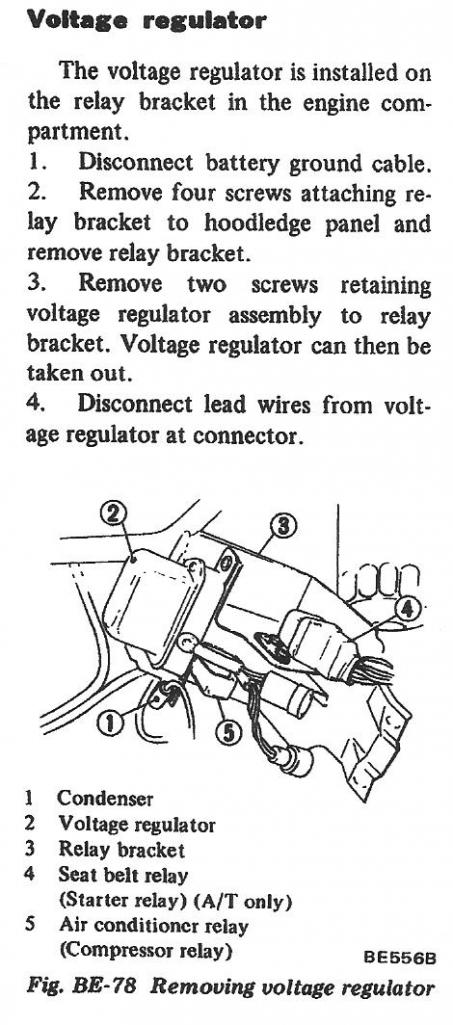

behind the metal bracket where the fuseable links are or someone has done the internal reg mod! all 77's still had the ext reg!
Hey all, thanks for the tip and the diagram but I'd been down that road. There is no pigtail and six prong coupler for a voltage regulator anywhere - and certaiinly not one where it should be - on my Z!!!
