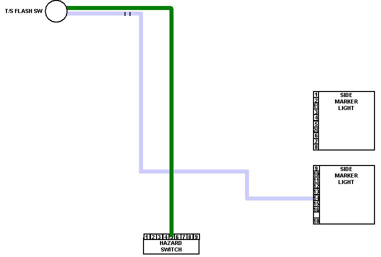

This is the diagram I have for the T/S switch, as you can see it seems like if the switch is out of the combo switch, so I was wondering if this could be a Flasher, i read in one of your post that this cars used 2 flashers, one for the T/S and one for the Hazard
That's exactly what it is. It's a FLASHER.
For your year it usually gets mounted on the dash support behind either the steering column or the center part of the dash.
The Hazard Flasher usually ends up by the passenger kick panel.

Thanks E, I just found the relay, it is under the dash and behind the seteering column, Since I am re-wiring from scratch, Can I move the location of this flasher to the passenger side so i Can have all th relays togheter in one location?
