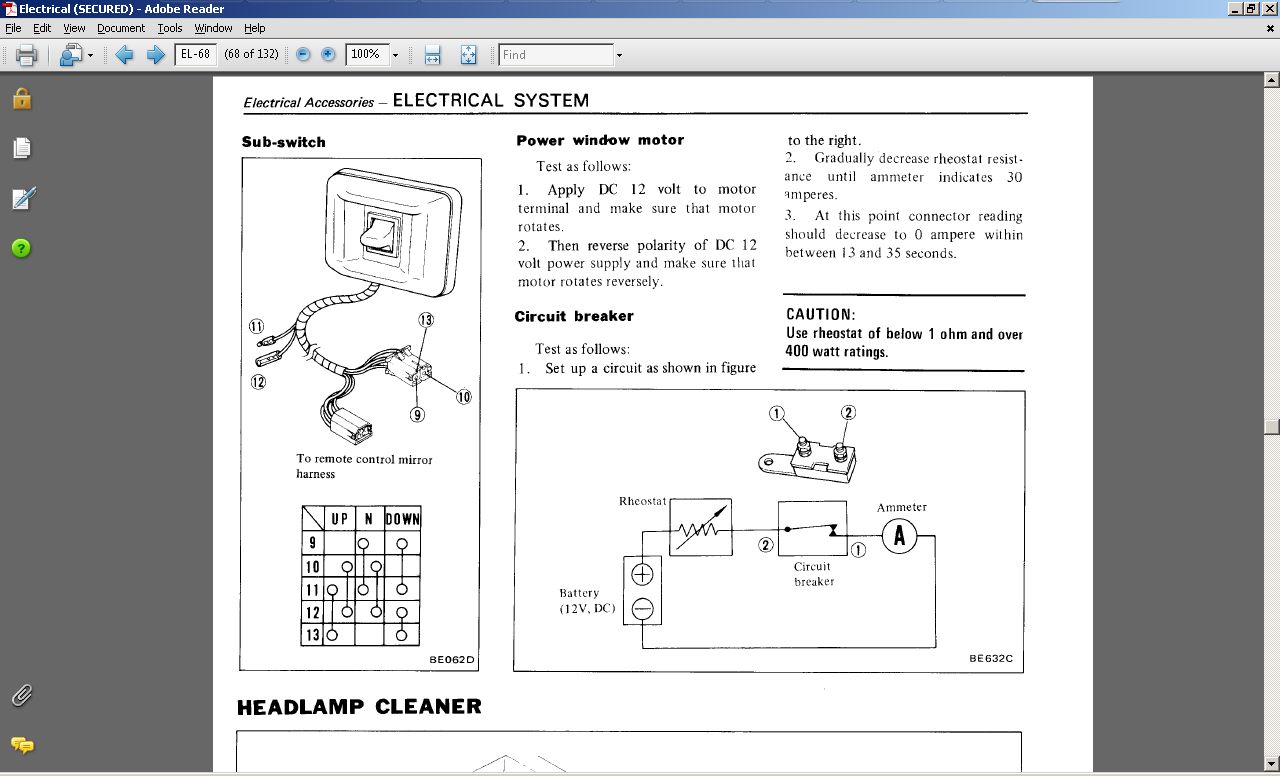

the seat belt timer does that also control the power windows?? the part I pulled out that is what according to the repair manual is thepower window circuit breaker , BuyNissanParts.com is saying is the seat belt timer, which isn't avilable any more :ermm:

How many connections does it have? The power window circuit breaker has 2 and the seat belt warning timer has 3.
it has 3 , is the power windows circuit breaker near the seat belt circuit breaker

Here is the part drawing for what you are looking for.
Mine had rubber boots over the connections-but looked the same. Just hit up your local autoparts store-what you get may not have a mounting hole, but it will still work like a champ! No need for OEM parts here!
If it has three connectors, he's is looking for the seat belt warning timer.
