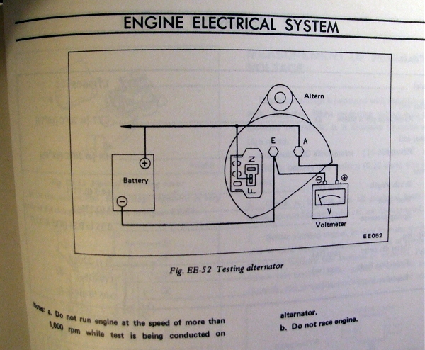

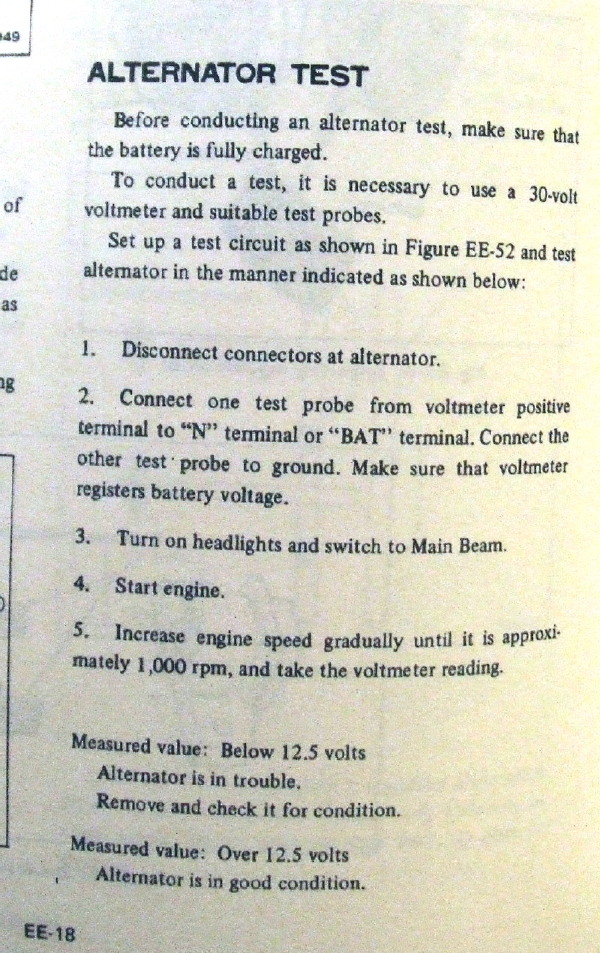

May 20, 200817 yr comment_248036 From the FSM... Pg. EE-18 & EE-19. I hope that this helps. For some reason I am suspect that the battery needs a full charge or may be failing.... But this should help with your diagnostics. Post mere as you learn. [/ATTACH] Link to comment https://www.classiczcars.com/forums/topic/28162-yet-another-charging-issue-thread-70-240z/#findComment-248036 Share on other sites More sharing options...
