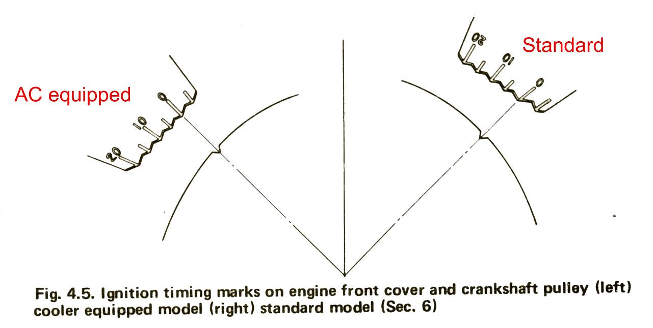

Ok... Trying to hit two topics on one post. Is there a diffirence between the harmonic balancer on an AC equiped car versus a non AC car.

Apart from having an extra pulley on the crank damper, the ignition timing marks are located in a different place.
Take this into account if you are mix and matching:ermm:
