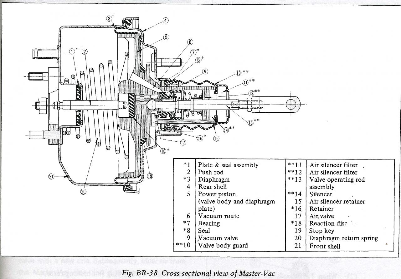

Patrick, I really don't think that the M/C to spacer and spacer to booster surfaces are anything near airtight.
The booster should have a diaphragm in it that has atmosphere on one side, the pedal shaft side, and manifold vacuum on the other side, the M/C side.
There is a seal that goes around the shaft, P/N#1 in the attachment, which seals the vacuum chamber from the atmosphere.
There is no mention of any seal either side of the spacer, so unless anyone else has a different opinion.....
