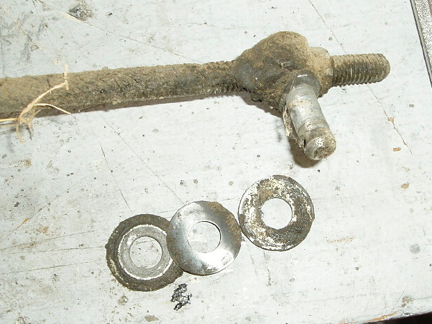

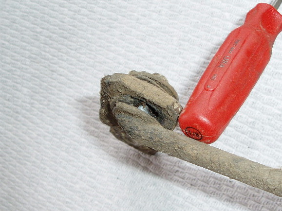

looks like the rubber donut. #25. here's mine LOL. the front one is CRUSTY and almost gone. the one off the gear selection handle (down linkage arm) is totally gone....

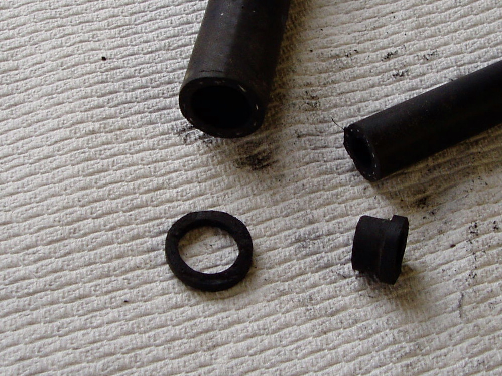

so i went through my old box of hoses and decided to make my own. some 3/8" fuel hose and some 3/4" coolant hose did the trick.

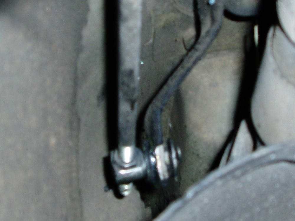

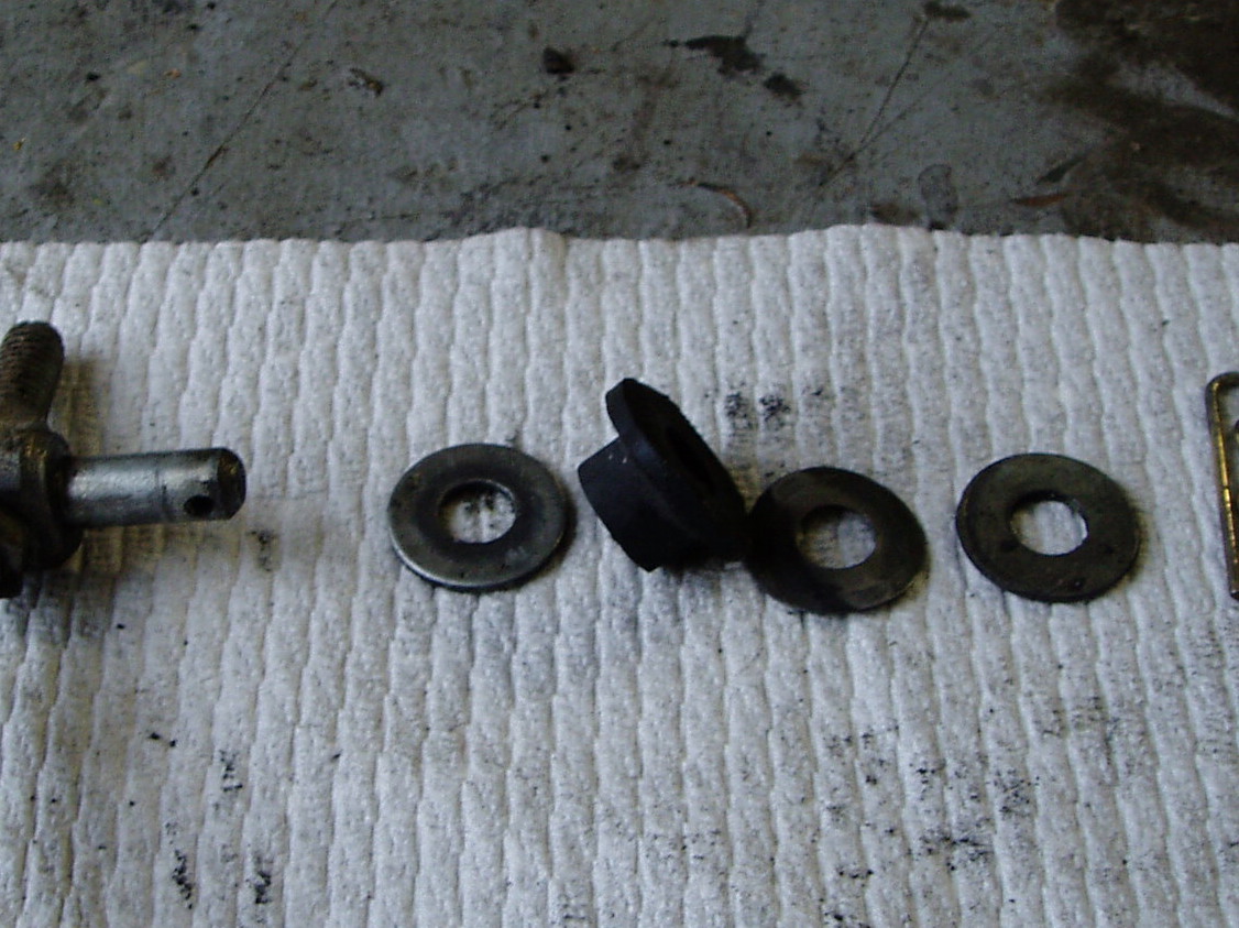

heres how. luckily the 3/8" hose fit snug over the rod ends, and the 3/4" coolant hose fit tight over the 3/8" fuel hose needed as bushing back for the washers. i rotated the 3/8" hose on fine stone bench grinder so i'd have a two-sized piece of rubber, glued the two together to make the 'stock' looking bushing. i needed to grid off some of the 3/8" fuel hose down so it wouold fit the inside of the linkage armatures. when installed it fit tight as a frogs butt!!!..like a new transmission!!!

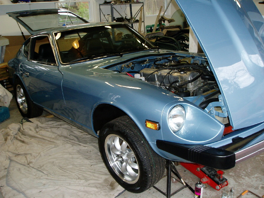

the photos are of the pieces i made and used. the install photo looks like there's sideways slack, but that is just the camera flash off the greased edge of 3/4" hose. ALL is tight as new!! the last pic is of my car :o
best of all it's done NOW...and for FREE
