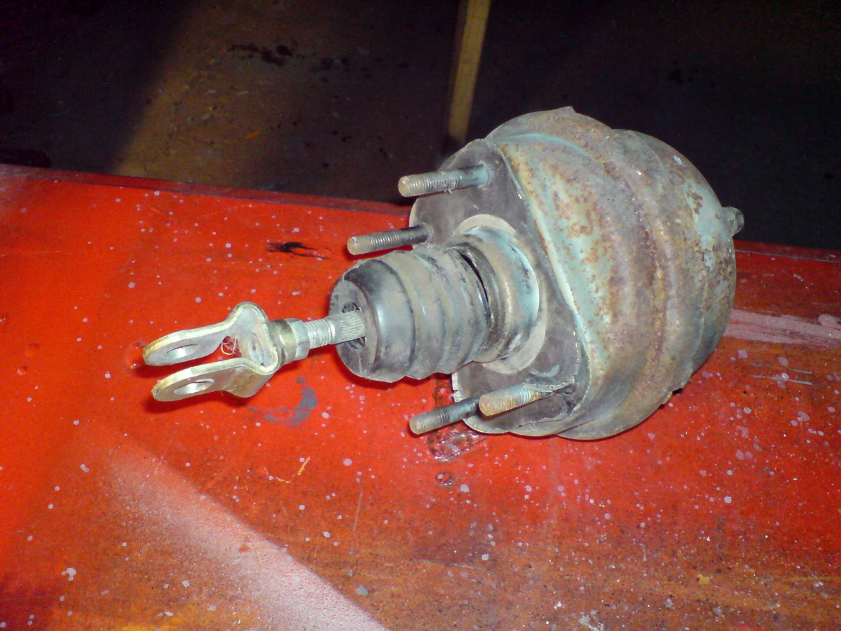

I need some advice on what to do with my break booster issues. I have std z32 300zx rear discs and calipers and R32 GTR front discs and calipers and I need to sort out a brake booster master cylinder system that will work with those calipers and (hopefully) fit right onto my 240k Skyline C110 1973. You can see the original booster fitted to the 240k was a joke and I swear it took power away from the brakes instead of giving it.
