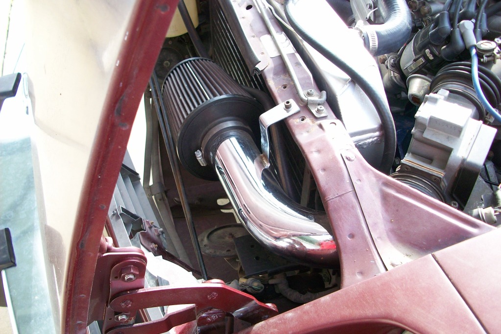

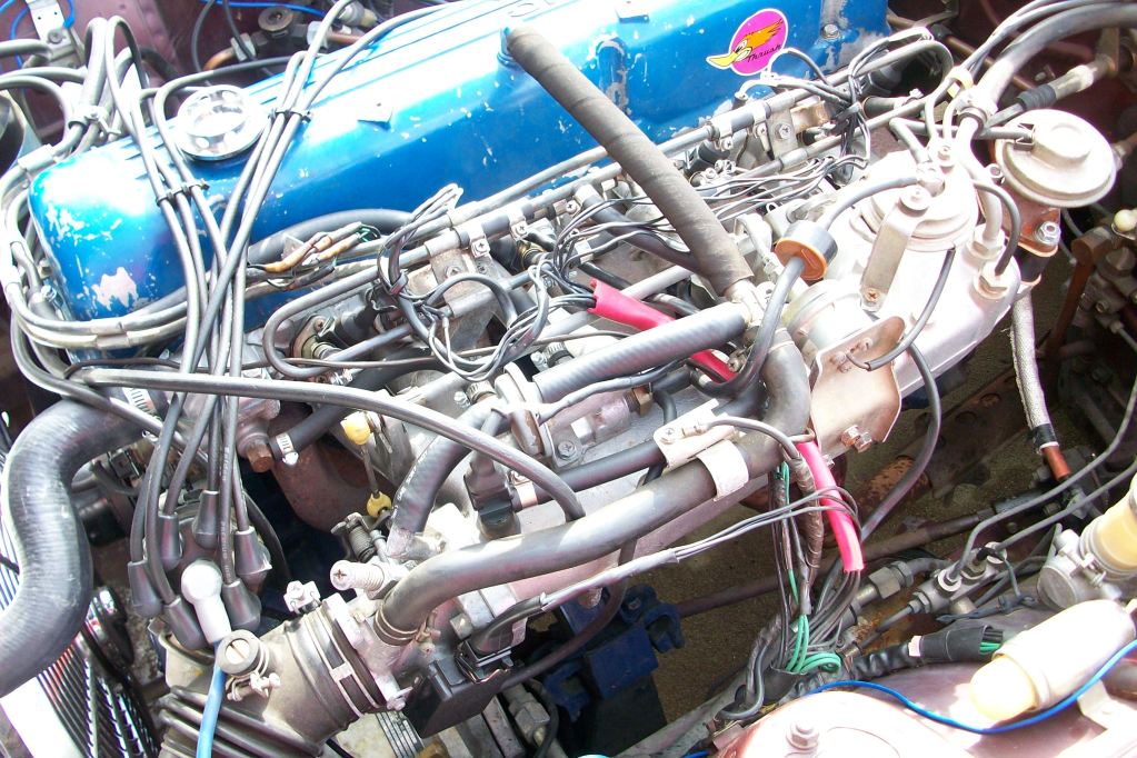

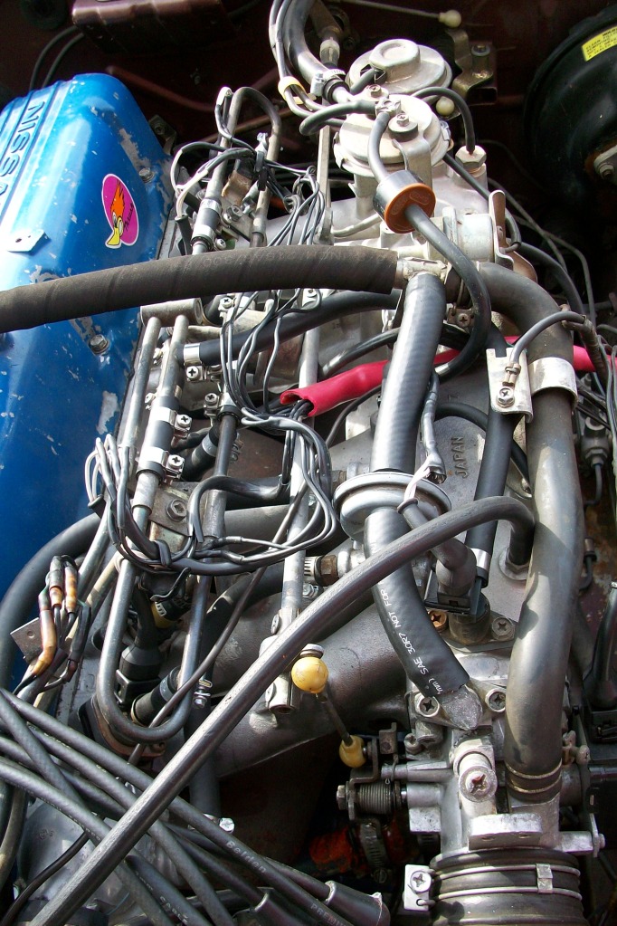

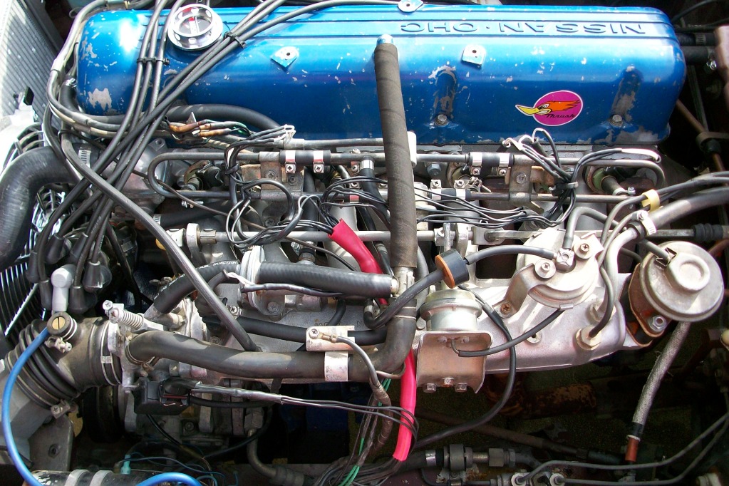

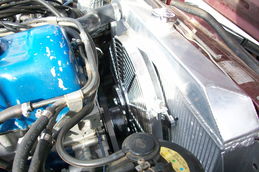

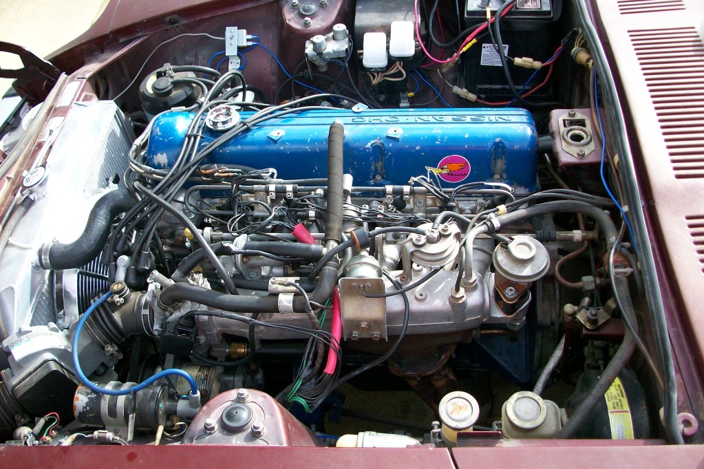

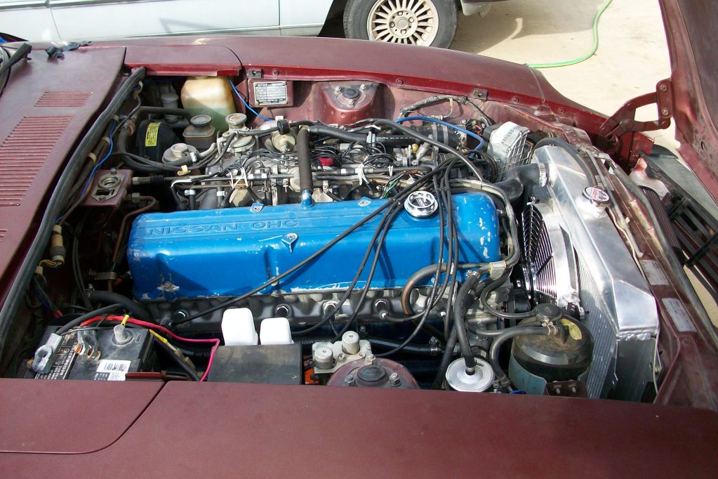

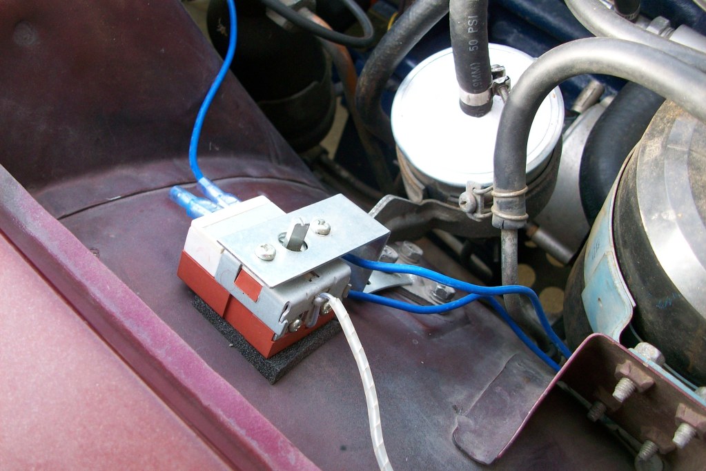

March 19, 201015 yr Author comment_313018 Hi Guys Like to know if you guys can tell me if all of my vancum lines are hooked up and or routed correctly. Here are some pics of the newly rebuilt engine I'm finally posting. Below is a link to my photobucket that has many more close up pics and angles to help view where everything is going. Remember it is an stock 1977 280Z 4 speed engine as mentioned above with the same engine and a newly rebuilt cylinder head that is the exact same as the old one it replaced, a N42. All new conntor plugs too. http://s235.photobucket.com/albums/ee59/partnateam/Ruby/ I also added pics of the MSA Aluminum Radiator, Thermostat control for it and the K&N Cold Air Intake Hoping to see if a line is wrong making my car run rich and not pass smog or if a injector is stock open. The injectors were rebuilt but one of them, the number 5 I think it is in the pics, was leaking where the top of green body casing meets the side of the injector casing. The warranty I believe is expired on them so I repleced it with a new Napa injector I originaly bought. Attached files for future thread searchers. ~Z~ Edited March 19, 201015 yr by WingZr0 Link to comment https://www.classiczcars.com/forums/topic/26413-the-state-of-things/?&page=8#findComment-313018 Share on other sites More sharing options...
