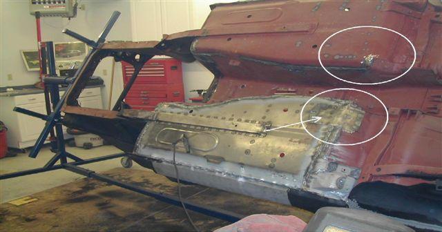

Well she is up on the rotisserie and the new floor panel seams are all welded up. Now that I can see everything so much better I realized that either I missed a reinforcement plate on the drivers rear floor or there wasn't one there originally(I think I missed it). Does anybody know if this is supposed to be on both sides?

there should be a doubler in the tunnel for the seat belt and then one to match the other side on the bottom all the way across.

Thank you for the reply. When I removed the floors to replace them there wasn't much left around the back corners. I had to fabricate most of the seat belt and floor bracing. Love your avatar and the color!!
