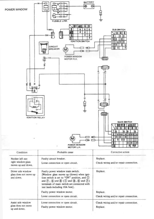

Don't know much about ZX's but here's a 1982 power window diagram and trouble shooting algorithm. Should be the same as an 83.

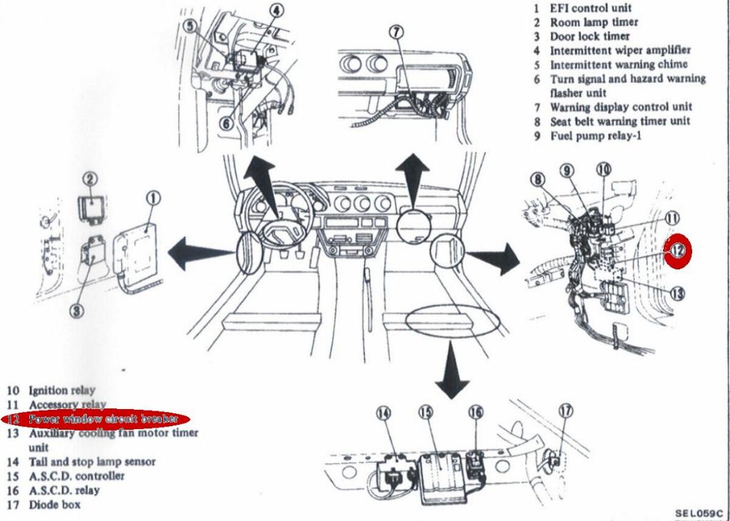

There is a circuit breaker in the ZX, most probably it is the culprit!
it looks like a small(1-1.5 inch) metal box with two spade terminals coming out-every time I have had that issue, it was the cause. It is in the passenger footwell. I'll see if I can't find the appropriate page from a ZX FSM for you.
WIll
Yep, that one-sorry for the delay, my keyboard went kafluey-
I also suffered from memory issues, the circuit breaker has stud connections for ring terminals, not spade terminals.
Will
I looked for the metal box, and all I see is plastic things with wires coming out. No metal boxes at all.
Is it hidden behind the plastic things?
