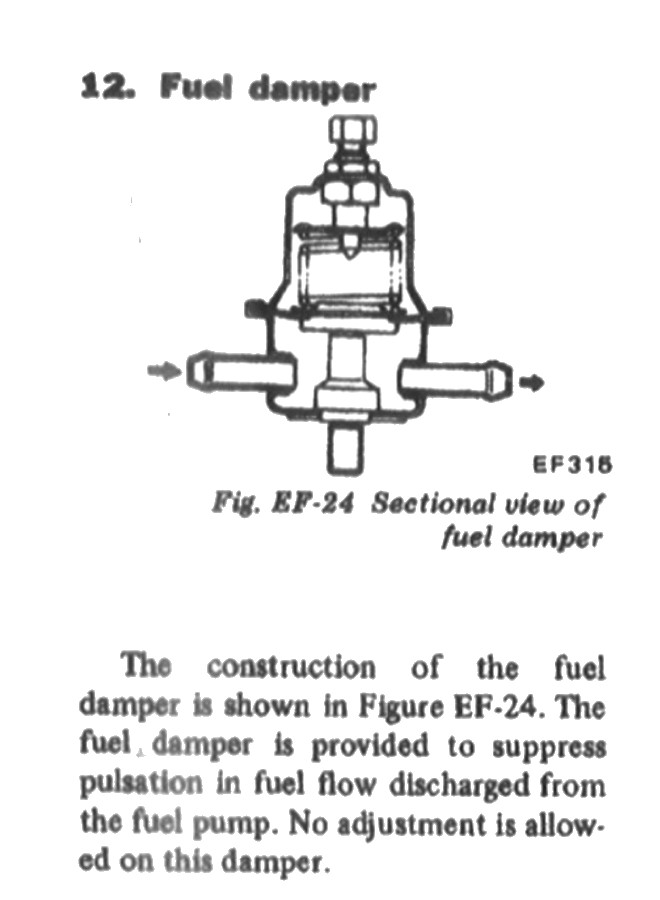

I think your talking about the fuel damper. I've never had a problem with one. According to the FSM, it's purpose is to smooth out the fuel pulse. Based on that, it could possible cause problems if bypassed.
Actually it's function is to "supress the pulsation in fuel flow". Here's a scan from the FSM.
Thanks for the help. I'll have to replace that dampener, and see what happens. While I'm at it I'm changing all the hard lines and hoses, and flushing the gas tank. The lines are pretty rough looking,and corroded.
