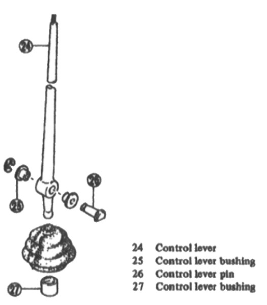

May 4, 200718 yr Author comment_208332 Are all three bushings there and in good shape? The two that the pin goes through to hold the shifter in place and the one on the bottom of it?bushings? I dont know what they are. could u show a picture for me? thanks. mann =/ Link to comment https://www.classiczcars.com/forums/topic/24210-280z-tranny-years/?&page=2#findComment-208332 Share on other sites More sharing options...

May 4, 200718 yr comment_208358 bushings? I dont know what they are. could u show a picture for me? thanks. mann =/ If you need them the part numbers are 32855-H1010 for number 25 and you need two and 32861-N4200 for number 27. Link to comment https://www.classiczcars.com/forums/topic/24210-280z-tranny-years/?&page=2#findComment-208358 Share on other sites More sharing options...
May 4, 200718 yr Author comment_208375 If you need them the part numbers are 32855-H1010 for number 25 and you need two and 32861-N4200 for number 27.thanks, sblake, but just out of curiosity, cause curiosity killed the cat, umm.. how does this relate to the reverse getting popped out? haha sorry im a totalnoob on transmissions.:sleep: Link to comment https://www.classiczcars.com/forums/topic/24210-280z-tranny-years/?&page=2#findComment-208375 Share on other sites More sharing options...
May 4, 200718 yr comment_208386 I wasn't sure if you mean the trans has no reverse when you shift into it or if it pops out of reverse when you shift into it. If the bottom bushing is not there or in bad shape it could keep you from getting the trans completely shifted into reverse in which case it won't stay there when you apply power. If that's the case then new bushings are worth a try. Costs less than a trans. Link to comment https://www.classiczcars.com/forums/topic/24210-280z-tranny-years/?&page=2#findComment-208386 Share on other sites More sharing options...

May 6, 200718 yr Author comment_208587 thank you thank you!but heres what i found out so farOk heres my dilemma, my reverse does jammed and pop outta gear..but heres the thing..i shift it in second gear then to reverse, and it works! but it wants to slip out to neutral, ..umm i dont know what to do so i might have to try the bushings, and change the trannny oil,, and see what happens. Link to comment https://www.classiczcars.com/forums/topic/24210-280z-tranny-years/?&page=2#findComment-208587 Share on other sites More sharing options...
May 6, 200718 yr comment_208599 Try the bushings first. If that doesn't work and you still have the original R180 3.36:1 diff and plan on keeping it, find a working 75-78 tranny and swap it out. If on the other hand you plan on changing to a later R200 diff, find an 81- 83 5spd donor and grab the R200 3.90:1 diff and tranny as a set. Link to comment https://www.classiczcars.com/forums/topic/24210-280z-tranny-years/?&page=2#findComment-208599 Share on other sites More sharing options...
