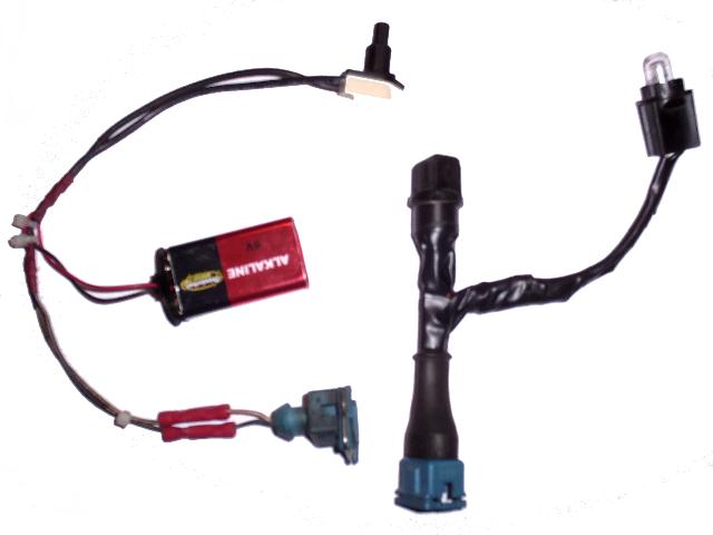

June 1, 200718 yr comment_211062 ........but it doesn't even look like the injectors are opening (don't know how to test this theory)...... I have a couple of tools I made that are helpful in that area. The one on the left consists of a 9V battery and connector (Radio Shack), a momentary switch, an injector connector, some wire, and a little soldering. Connected to an injector either on or off the car, you will hear an audible 'click' when you push the button if the injector is good. At least, electronically speaking, it could still be clogged. The one on the right consists of a gutted air rerulator with the coil removed, a side marker light and socket (junkyard), an injector connector and some wire. With this one, you remove the connector from an injector, place the bottom connector on your injector and the wire for your harness on the top connector. While the engine is cranking or running, if the bulb glows, your getting a signal (pulse) to that injector. Link to comment https://www.classiczcars.com/forums/topic/24129-1976-280z-engine-wont-start/?&page=3#findComment-211062 Share on other sites More sharing options...
