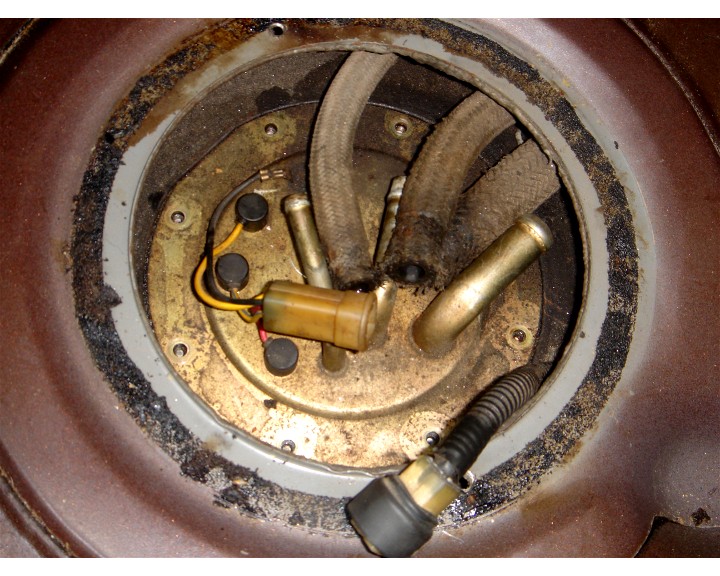

A question-did you happen to check the condition of the inside of your gas tank? Odds are that you've got some crud in there that is getting sucked into the system.
To get to your tank, here is what you do-
1. lift up the padding in the hatch area. You will see a circle with two screws. open it up.
2. now you will see the top of the tank, with three tubes and hoses, surrounded by 8 screws.
3. Carefully unscrew them (they are small and easy to drop). Unfasten the hoses, and disconnect the plastic wire connection thing.
4. Carefully pull the sending unit from the tank. Do this slowly, there are tubes and things going everywhere, it can be a pain.
5. Look inside, see all the rust.
If your tank is gunked up, odds are that that is the problem.
do a search on the site, and you will find lot's of information.
