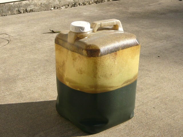

First off, I know that you have to be really careful with the old fluids and they have to be properly disposed of. When draining the fluids, do you need to keep them seperate or can they all go into the same plastic container for disposal? What are some good containers or drain tubs to use and where do you dispose of the old fluids?
First off, you really only need to keep your anti-freeze/coolant and oils seperate. You can however mix the engine, tranny and diff oils with no problem.
As far as a good container to put them in, there are probably lots of choices, but my favorite is the one I included a pic of. It's a 5 gal plastic container that restaraunts get their deep fryer oils in. Alot of times you can just check their dumpsters for ones that have been discarded or go in and talk with the employees and ask them when they usually change out the fryer oil and see if they will save you one or two containers, and then arrange to come pick them up. These are great containers as they hold alot, have a big handle and a large opening to pour the fluids in!
And finally, most of your auto parts stores will have collection bins available and will allow you to dispose of your fluids at no charge.
