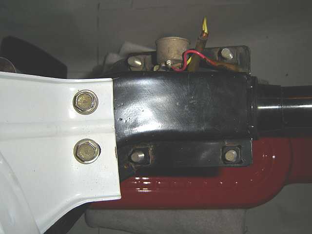

The steering column is held in place with four bolts at the firewall behind the brake/clutch pedals and four more bolts in the picture below. If you remove all eight bolts you should be able to lower the steering column and kind of angle it towards the drivers door so that the upper section of the shaft can slide out/back in.
I hope this helps and I don't know of any other way to get the upper section out. Maybe someone here has discovered a slick way of doing this job.
