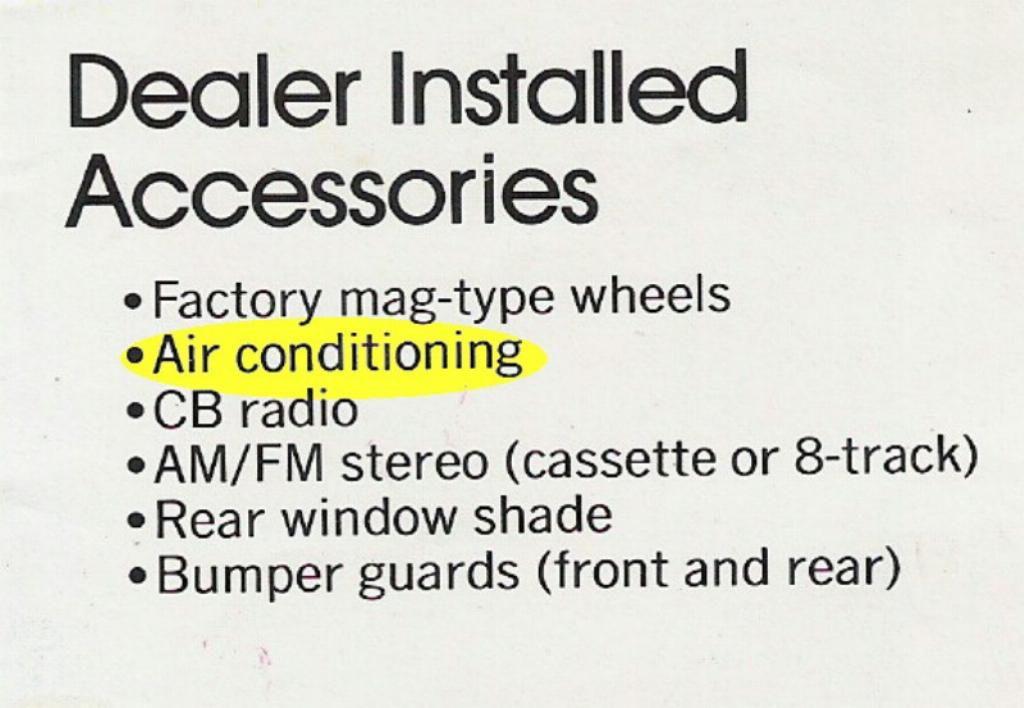

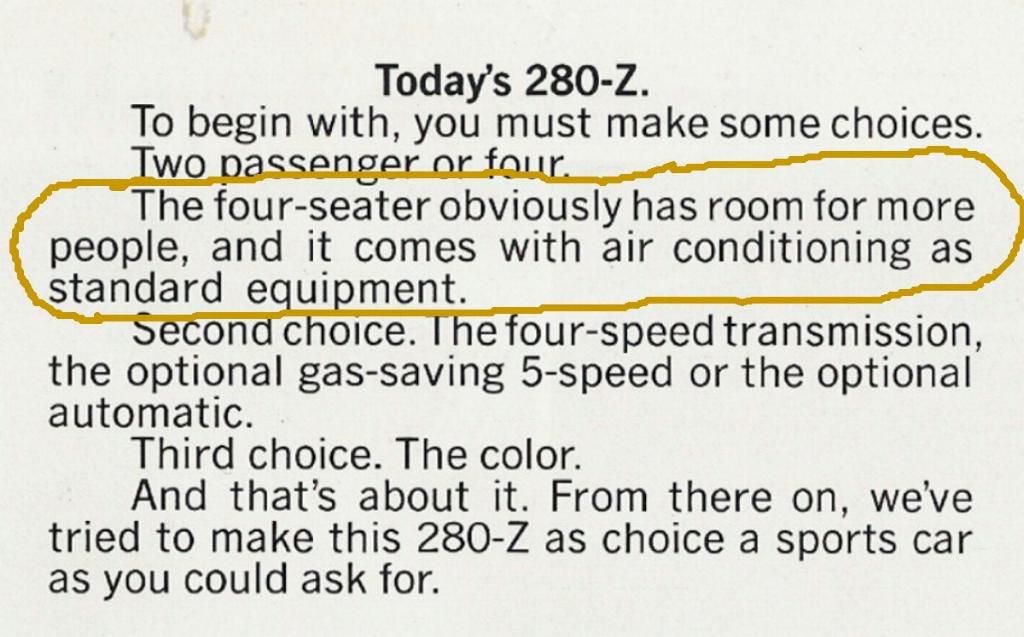

4000 higher or lower? My 78 is about 4200 lower than yours and it has aftermarket air. And it works fine. Someone wronlgy contended that factory air lasts longer than non factory air eariler in this thread. Maintainence is the key for any type of ac system. And as far as what was standard or dealer installed in 78, these scans are from the 78 sales brochure. According to it, ac was factory installed on all 2+2's and dealer installed on two seaters.
