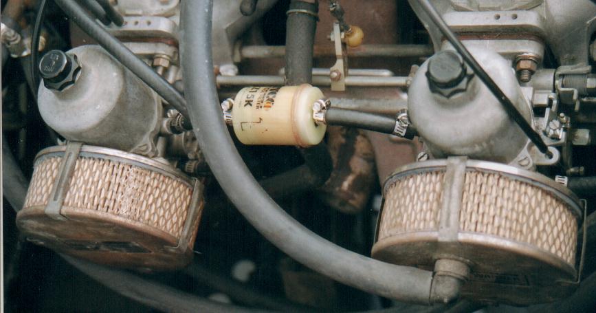

I had the same problem when I first bought "Precious". The PO was obviously a fool with a complete disregard for safety as he/she/they/them set up the carbies like so.
They weren't Z carbies. The linkage that runs horizontally across the firewall proved to be too long, causing a "tight spot" which, when the accelerator was depressed past the "tight spot", caused the car to LEAP forward.
Fitting a pair of Hitachi's and a shorter link fixed both problems.
