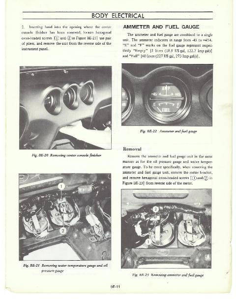

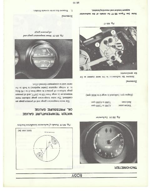

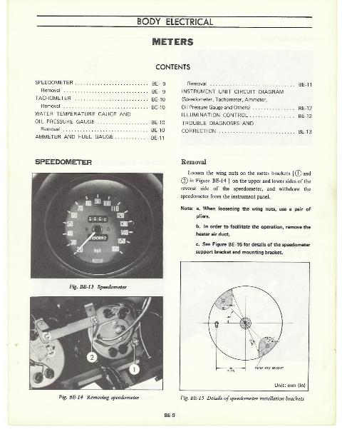

Try these from the FSM and see if it helps. Like montoya_fan01 says it should just unscrew.
Hope this time the pics will go through right.
