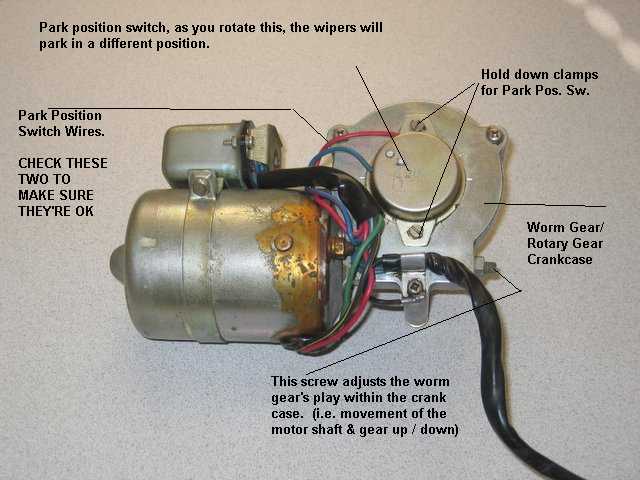

The 71 does have a mid-cycle park feature which has a couple of wires attached to the back of the wiper motor crank-case. If one of those wires is disconnected or not making proper connection due to a break etc. it will keep cycling as it never gets to the "park" position.

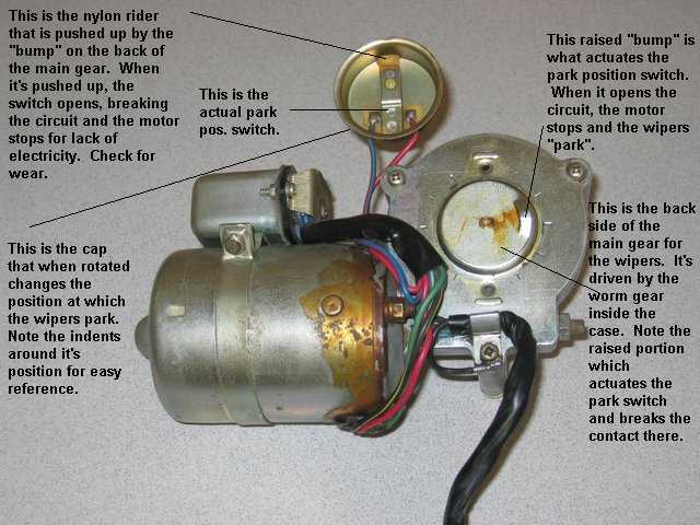

Well, the wires seem OK, at least from visual inspection. I loosened the screws and moved the Park Position Switch around some, but the wipers still wouldn't shut off. I'm wondering if the metal tang on the inside of the Park Switch isn't making contact???
Do a continuity check to ensure that the wires aren't broken someplace along their length.
As far as the park switch, that "bump" is supposed to lift the reed and break the circuit. Is the nylon pad worn out?
After this, the only thing I can imagine that may cause the problem is a down-right short circuit in the switch itself.

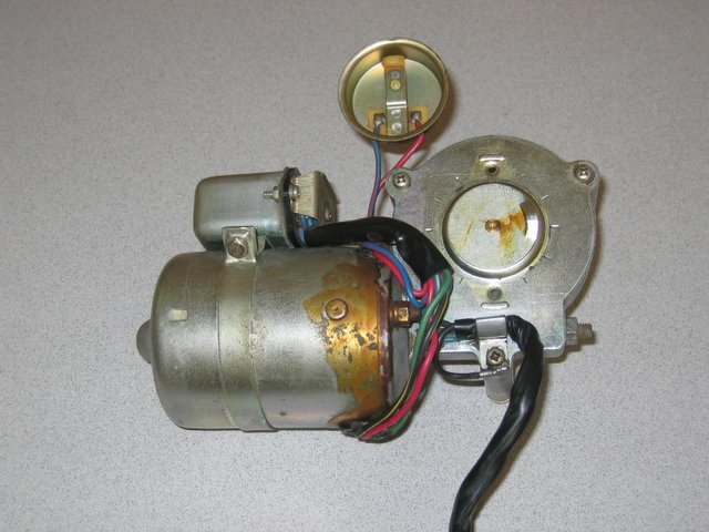

See the following pic.
Hope it helps.
