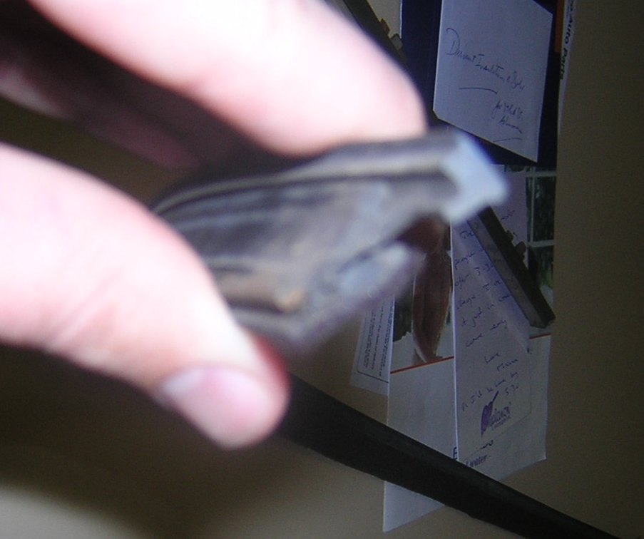

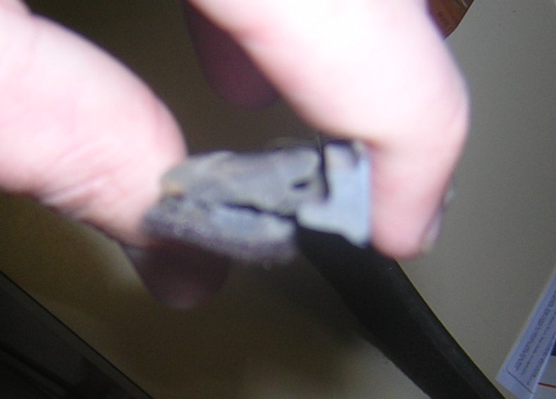

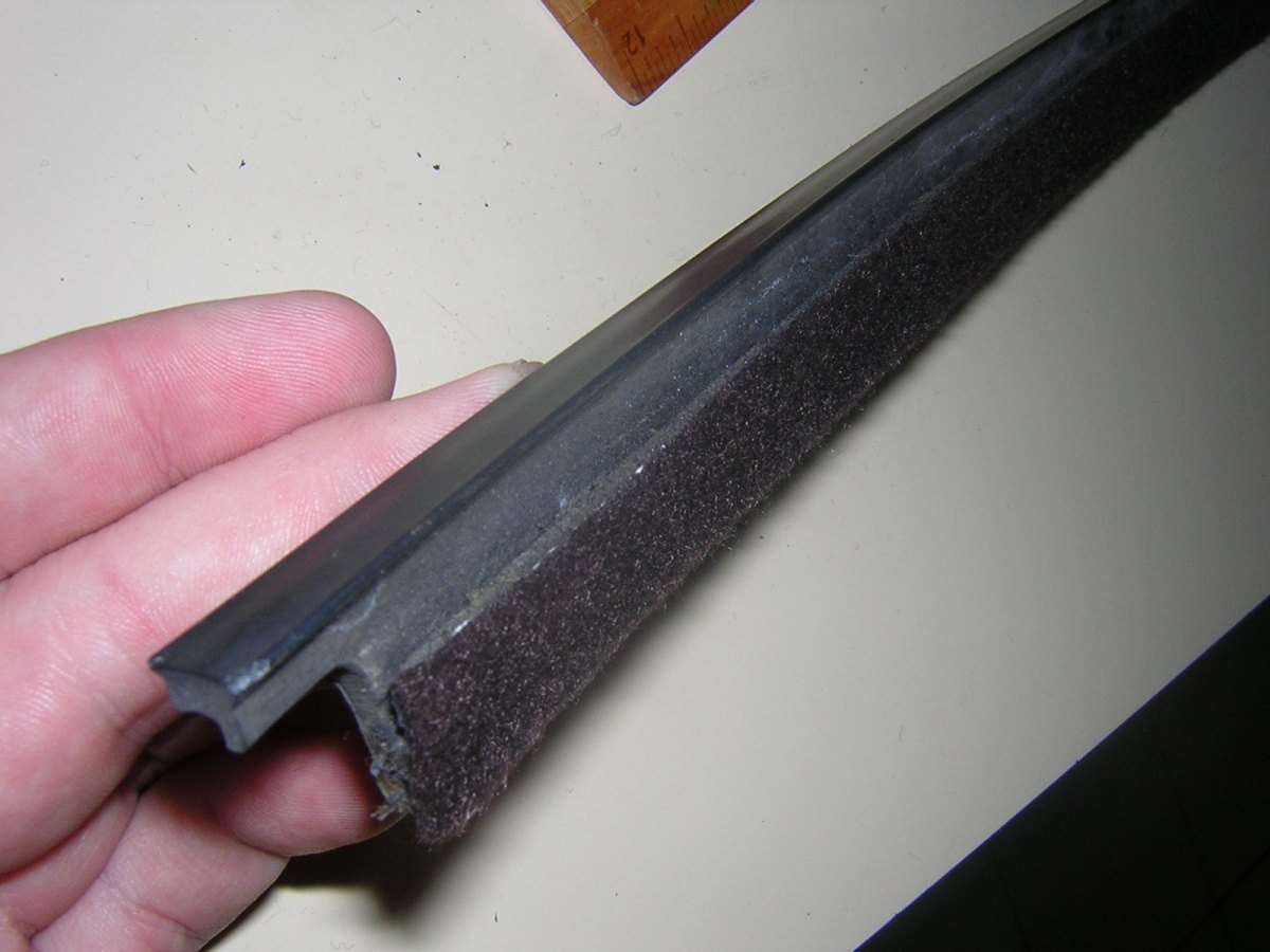

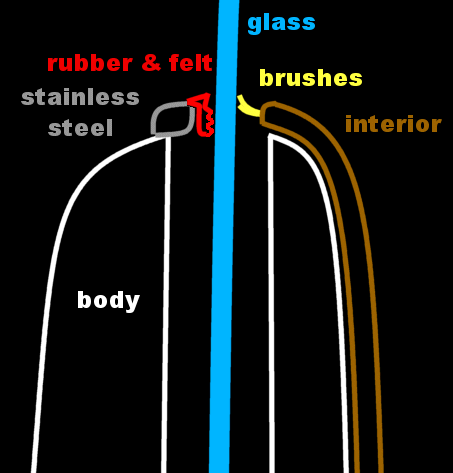

This is not 240K specific, as IIRC the Z (and most other cars) are the same in this respect. Glass scratches. You may recall I posted a while ago asking if there was any way to repair those small streaking scratches that are barely noticeable but really annoying for the car owner. Well, it's only getting worse, and the cause must be this felt that rides against the window when rolling it up and down. I thought I'd see if I could replace this stuff. I've included a couple of pictures and a diagram (the red part is what I'm talking about) to let you know what I'm talking about.
I bought some stick-on felt stuff from a hobby store and have cut it to fit (shown in one of the pictures). This looks like it might do the job, but I'm worried about how waterproof it will be, whether it will hold any junk, and the extra pressure it will exert on the glass seeing as it adds an extra 2mm to the part. Note that the rubber part and felt (at least that's what I think it used to be) part are one and the same.
Has anyone tried to fix this before? Ideally I'd just get a replacement for the whole rubber part, but I wouldn't know where to start to find one of those... So anyone have any bright ideas? And before you say check the parts car, those are just as bad. Thanks!
