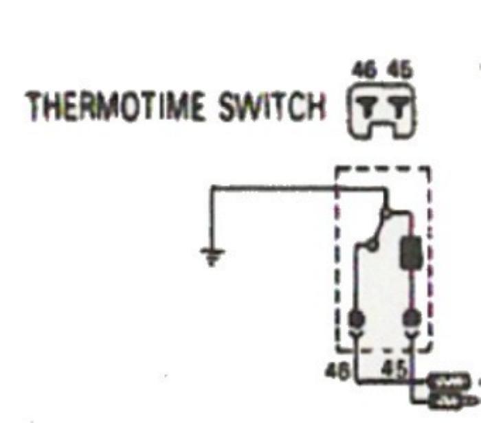

What is the easiest way to determine if the two wires to the Thermotime switch connector are reversed?

If you view the thermotime switch connector from the front with the open part of the clip facing downwards, the wire on the left goes to the female plug and the one on the right goes to the male plug. As far as removing the contacts once they're inserted, I wouldn't know the answer to that because mine already had wires in them so I cut the old connectors off and soldered and heat shrinked the new ones on. I don't consider your question trivial at all. It took a while to come up with a definitive answer. I tried to check the wires on both my cars but since they were wrapped, there wasn't a way to see which wire ended up where. The scan is taken from the 'EFI Bible'.
EDIT: After thinking about this, would it really matter where the wires go on the connector since all they seem to do is complete a ground when the switch is closed?
It's beyond me. I haven't 'touched it' yet. I was, and I still am, confused because of what I read about power being supplied only when trying to start, then if it didn't start power would be dropped and cold start valve wouldn't dump the gas because of some simple heater within the thermotime switch which disables the cold start valve from operating.
At this point, I'll say you are right -- that is, all is a function of the thermotime switch itself and all it needs is what you said. Now, I feel less worried about the situation. Thanks!
I'll spend some time checking it out.
Ummm, look. Calm down. Just connect one wire at a time. If something wierd happens (engine gets worse than before, after warm up), unplug the cold start valve. If this fixes it, you have the wires backwards. Don't be afraid, it won't explode! (unless you're me and prone to doing shady modifications in a parking lot with cheap or scrounged parts, in that case I take no responsibility for my errrr.... I mean: your actions). Though blake is probably correct, the injectors also don't really care which wire is where.
Well it's really simple. The power comes to the thermotime switch from the ign switch, through the ign relay. The thermotime switch is basically another temperature sensor with a heating coil in it and it will only be closed for 8 seconds and that's if the temperature is low enough. I the temp is low enough, the thermotime swich completes the ground. From there, the signal goes to the cold start valve, completing the ground, and injecting the extra fuel needed for a cold start. I tested this theory morning at 6:30am by temporarily switching the leads on my 810 and it started right up.
