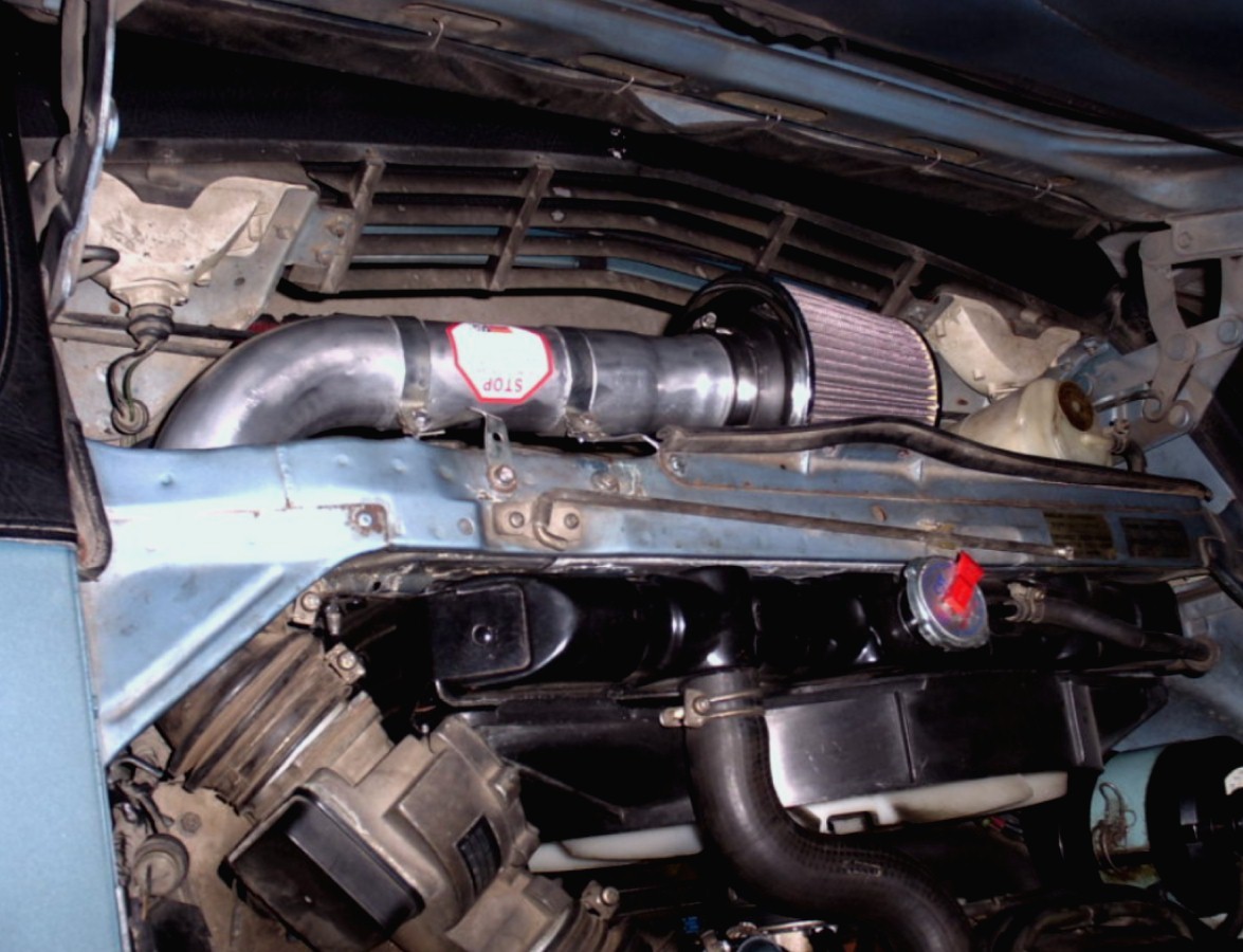

August 23, 200519 yr comment_135339 Yeah, I think it will. 12" is quite a bit. It is a slightly bigger radius too. I'll get it to work I think. Then I'll post the construction specs on another part of the site. Link to comment https://www.classiczcars.com/forums/topic/16794-cold-air-intake-not-a-fifteen-minute-install/?&page=5#findComment-135339 Share on other sites More sharing options...

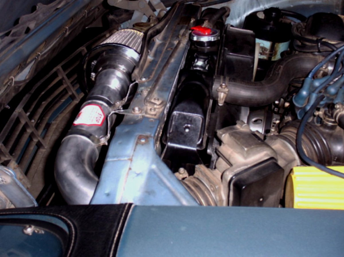

April 25, 200619 yr comment_165064 Well, I finally did find some aluminum tubing. It's 2 1/2" .016 with a 4" radius. I cut the excess straight piece from one end and had it swedged to fit the filter opening and over the other end of the pipe. I also had the other end swedged to fit the afm boot. Got it from a place called Global Technologies on the internet. Total cost was $45. $43 and change for the elbow inlc. shipping and 2 bucks for the swedging at a muffler shop. What I like about it is that it puts the filter in the center of the car unlike other kits I've seen. Link to comment https://www.classiczcars.com/forums/topic/16794-cold-air-intake-not-a-fifteen-minute-install/?&page=5#findComment-165064 Share on other sites More sharing options...
