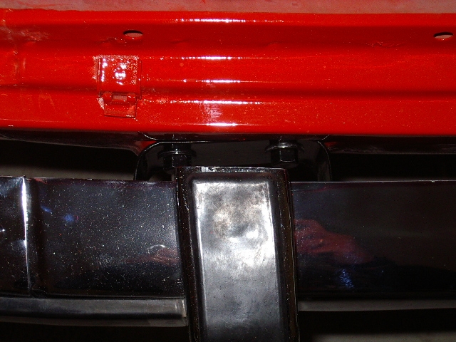

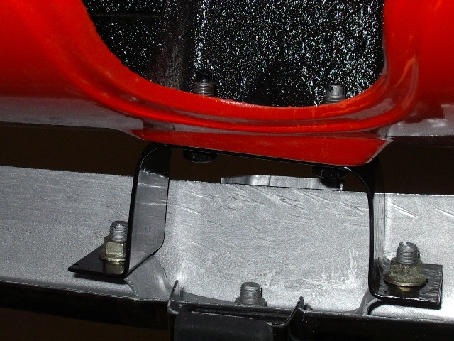

Edit: Here are some pictures of the 240 brackets that I thought you had. Top and bottom view.
