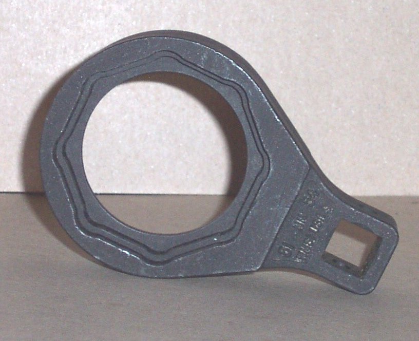

Just a follow-up on my previous post. Snap-On has this tool (WMS1) which is a functional eqivalent for special tool (KV40100800) Appears to be special order only if you want to get one from Snap-On. Not a very cheap tool tho...$75.00-$80.00. Well worth it tho, if you don't want to chew up the strut packing nut. Fits 51mm-54mm on one side and 55mm-58mm on the other side.
