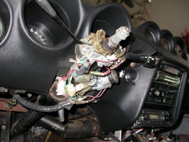

Here's one of the best pics I have of that area from the disassembly of my '70.

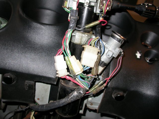

And one more, but probably not as useful.
mdbrandy...what do the two wires coming off of the bottom of the ignition switch conect to?
Unfortunately, I don't know. This pic was taken over a year ago, and the parts are in one or more boxes right now. Also, I never got to actually drive the car, except from the PO's house to mine. So, if I had to guess, I'd say an ignition buzzer maybe?
Sorry I can't be more help on that one. I took the pics so I could have a reference when it's time to put it all back together. Hopefully it will be enough :).
Mark
