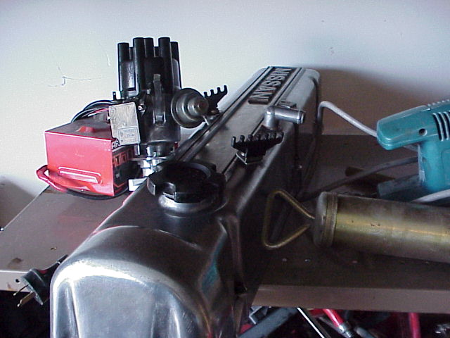

What you're looking for is here in the attched pic.
Notice the black box on the distributor, this is a module, 2 wires come off it and go the coil, black goes to - terminal, blue to + terminal.
Have fun...
