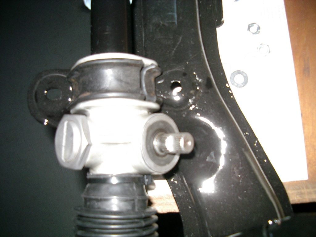

Hi all,
I try to change my driver side steering rack bushing to an urethan one from G-Machine. I'm successless. Whatever I try, at the cut i have a gap of about 1,5 cm. Has the cut-side to be upside or downside? Thanks for your help
Rolf
https://www.classiczcars.com/forums/topic/10193-steering-rack-bushing/
Ed, thank you. I did it like you did and it looks the same.
Does anyone know whether this is correct? A mistake in the steering could end bad to us so please let us know. At the Codrivers side the bushing matched properly.
Rolf
that's how it can be....wouldn't worry about it...something that helps when first putting it on is to dowse it with hairspray, makes it really slippery putting it in, and then when the hairspray dries it's like glue.....unless the item is oem, you will probably have a gap, no biggie, just make sure it's clamped down good!
