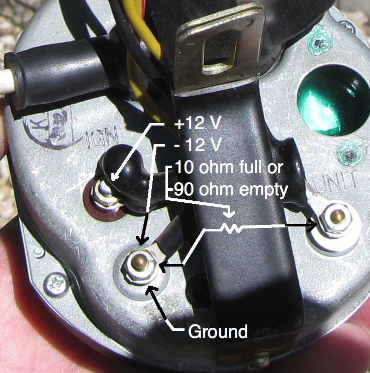

The picture below is the back of a 1972 Z car gas gauge. Ignoring the two large ammeter white wires (not visible in picture) whose gauge I would love to measure one connection is labeled IGN, another UNIT and the third one (the ground) has no label. I just tried connecting a 12 V power supply as indicated on the picture while a 90 ohm resistor was connected between ground and UNIT and the needle moved up to empty. A 10 ohm resistor made the gauge move up to full.
For testing the ground all the way back to the gas gauge an easy way would be to connect a 10 ohm resistor across the two wires (I hope there are only two) at the tank connection to verify the gauge goes to full.
I have noticed from reading posts that most problems with an erratic gas gauge reading are caused by the sending unit being bad. I fixed mine but I think a better approach is what most people do, replace the thing.
I am not sure I answered your questions, if not ask more. I love killing off electrical gremlins.
Interestingly my power supply made a slight noise when the gauge would thermally cycle and I could hear a slight click from inside the gauge when it cycled. I understand it has a thermal strip that moves back and forth but that is all I know about how it works. The needle slightly moved when I heard the click too.

Thanks. I was testing the resistance between ground and "UNIT" so I guess I did THAT right! It was showing around 35 ohms but was sporadic. This lead me back to the tank.. I removed the 2 wires from the sender, put them in contact with eachother, and then checked the gauge. Sure enough it went to full. I guess the gauge itself is fine!
With that said, the connectors on those wires going to the sender are JUNK! I tightened the black one up with some pliers and stuck it on there as good as I could. The gauge seems to have gone back to its previous operation. I know the tank is almost full but it went back to showing just shy of 1/2. This is good enough for now as at least I'll be able to tell when Im in the empty ballpark, but I'll have to pull the sender to test further! Just gonna keep driving until I empty the tank :)
