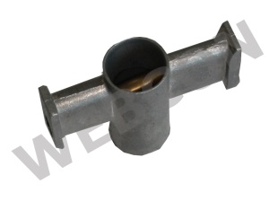

April 3, 201411 yr Author comment_444876 In your first post you said, "I can actually see fuel coming out on this one." Where, exactly, is the fuel coming from? When you open the choke all the way for the 5-10 seconds it stays running, you can see a steady drip from the "auxiliary venturi" this thing http://atspeedracing.co.uk/products/images/71115_1.jpg Link to comment https://www.classiczcars.com/forums/topic/48907-weber-carb-needs-choke-to-run/?&page=2#findComment-444876 Share on other sites More sharing options...
April 3, 201411 yr Author comment_444877 Come to think of it, if this thing was cracked and thats thats why it drips fuel could that be my issue? Something new to check tomorrow. Edited April 3, 201411 yr by 2sixTZombii Link to comment https://www.classiczcars.com/forums/topic/48907-weber-carb-needs-choke-to-run/?&page=2#findComment-444877 Share on other sites More sharing options...
April 3, 201411 yr comment_444887 Fuel dripping from the aux. venturi suggests high fuel level in the float bowl. The fuel level is normally very close to the level of the discharge port in the venturi. When the fuel level is a tiny bit higher than the discharge port it will drip out. Low the fuel level a little bit and see what happens. Link to comment https://www.classiczcars.com/forums/topic/48907-weber-carb-needs-choke-to-run/?&page=2#findComment-444887 Share on other sites More sharing options...
