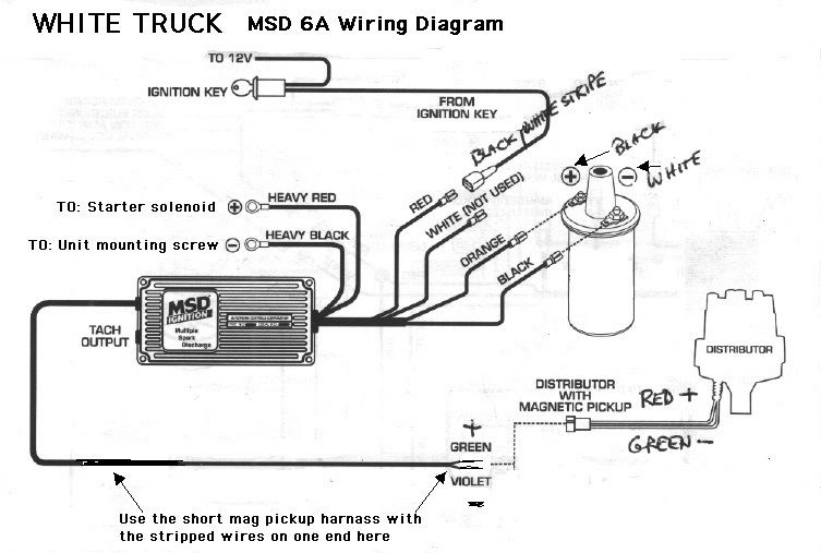

has anyone here used an MS 6al ignition unit? I'm trying to find the most painless way to install it. I have the tach switch too.
I think this is correct, but what do i do with the ballast resistor?
Bypass it and remove it. That is exactly how I installed mine.
