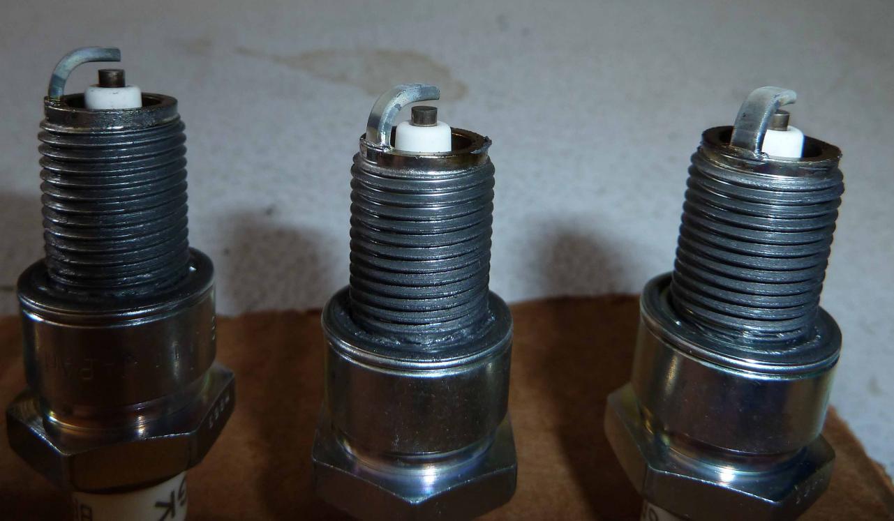

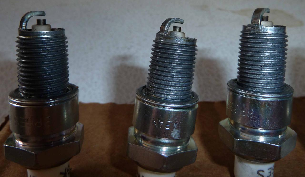

After adjusting the TPS/throttle spring the spark plugs look ok, dry and on a lean side.
Spark plugs order:
Left picture: 6-5-4
Right: 3-2-1
