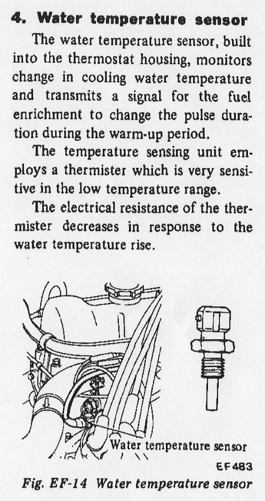

Check the connections to your water temp. sensor. I know that was the problem with my 76.
