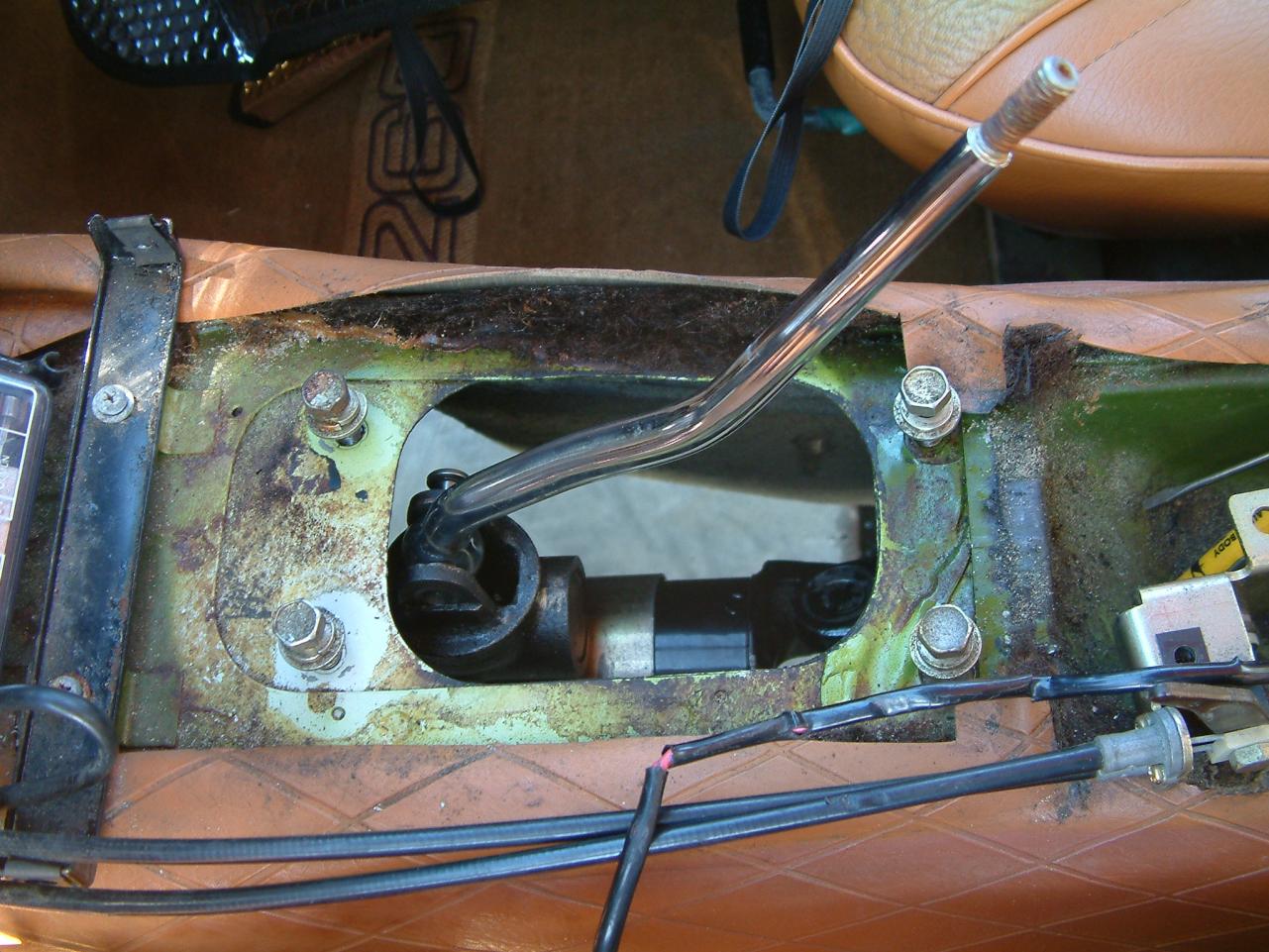

#1 - The shifter does not come up in the center of the hole on the trans tunnel. It's like the car's a '71, but it's a '73 for sure!. It looks like the tunnel has two possible cut-outs, one for manual and one for auto. See the attached photo. If I cut the tunnel along the foreward line to make the hole bigger, the shifter will be in the center of the hole (good), but the shift boot I bought will be too small (bad). The boot I bought has a rubber lip that fits around the inside of the tunnel hole. Should I be using the boot that is held down by a metal ring ? (I have that ring). If so, the bolt holes won't line up with the bolt holes in the tunnel. According to the Nissan parts fiche, there are two different floor sections, one for manual and one for auto. Help?

#1 - There are two rubber boots needed for the manual transmission. The round accordian boot goes around the chrome shifter and covers the opening in the top of the transmission to keep dust out. The second boot is for the tunnel (which is the one you are asking about). Yes use a body saw and cut the tunnel going forward using the rubber boot lip as your template. Use sheetmetal screws to hold down the metal ring that goes over the boot.

You will notice that the metal ring has 4 holes that are not in an equal pattern, these will line up with dimples in the floor to locate it properly. You can then use the inside of the metral ring to mark where the forward section of the floor needs to be cutout.
