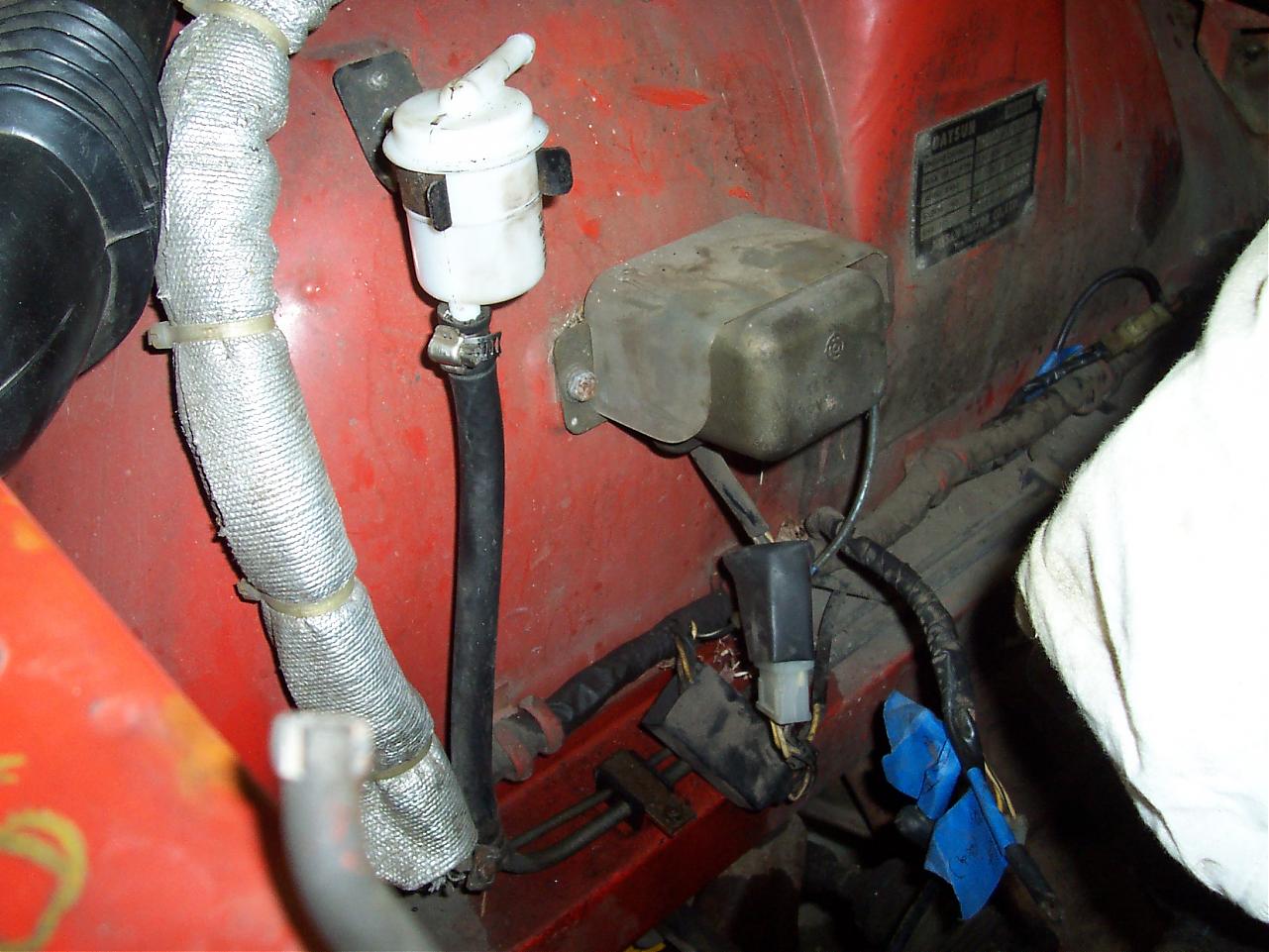

This is kind of an embarrasing, but I can't find the fuel filter anywhere except for the screens in the carburetors. There is another one right?
There should be 1 right on the passenger side inner fender (pic), and another inside the electric fuel pump (if you have one) behind the fuel tank. Mine also has e in-line, right after the elec. fuel pump. But I'm pretty sure that one was added by the PO.
Ok I don't feel so stupid now for not being able to find it because there isn't one. Which means that my stalling problem is probobly because of crud in the gastank.
