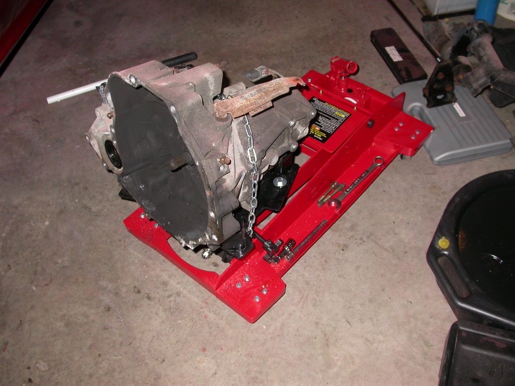

BTW, if anyone is looking for a cool transmission jack, I got the one in this pic from Harbor Freight for $125 shipped to me. It's good to 800 lbs (who cares!), but has two axes of adjustment of the platform (side to side and front to back) just by turning a couple of knobs. Made it really easy to adjust to the correct angle to get the transaxle out, and I anticipate it will be easy to get it aligned to put back in. And now I've got it for any other Z trans or differential I need to lift into place :).
