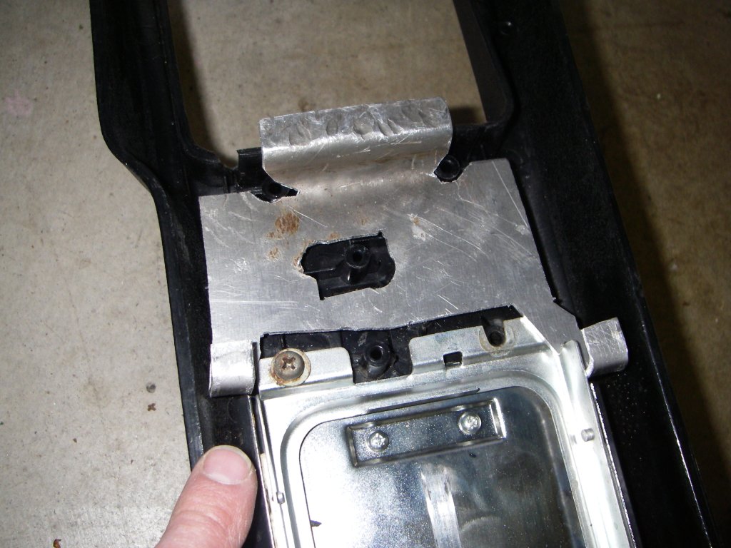

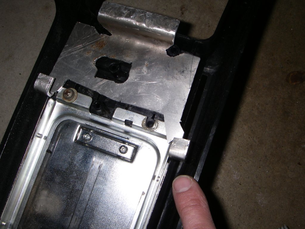

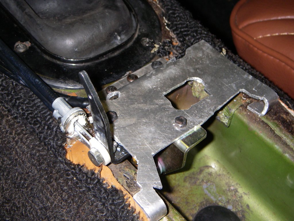

I was so thrilled by this thread I went out and hacked up my own. I think Mike's is better, but it works...
I had some issues with the ash try top hitting the back part of the bracket which I point out.
