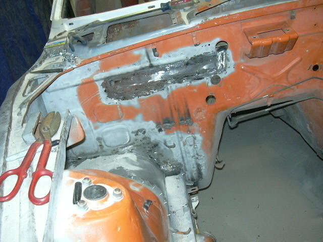

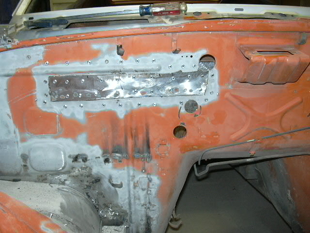

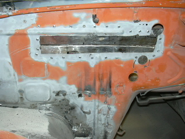

Here are some pictures of how I did this one. Note the wire harness pass through hole is missing. I too welded it up. Fabbed pieces to redo the fender well and moved on.
Thanks for the info and the pictures. These pictures will help out a great deal. I think I'm going to try to tackle it this weekend so I'll let you know how it turns out.
