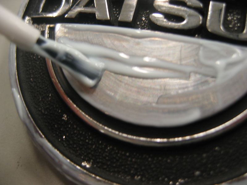

I painted the Liquid mask on the chrome parts with a hobby brush, and let it dry for about 1 1/2 hrs. Then I used the knife to gently cut the mask off any black surface.

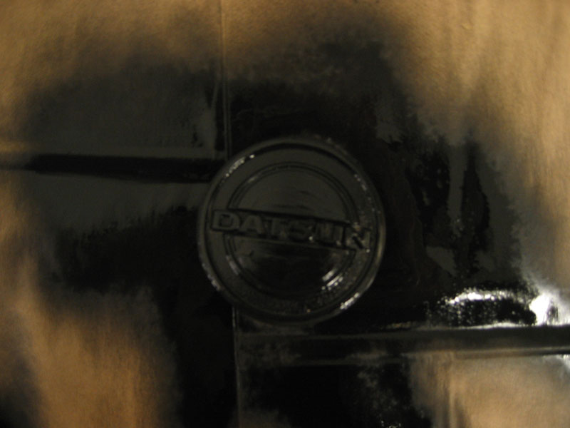

Then I painted the whole thing black. That stuff comes out lots of pressure for a little can.
I waited and that black paint dried in about 1 hour.

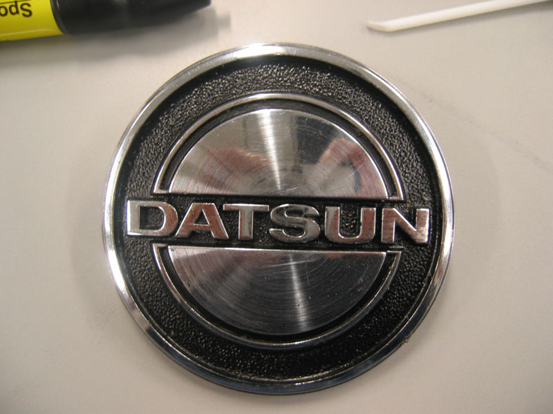

Then it got tricky. That mask just wouldnt come off easily. I started scratching it off with the back of the knife, but that was too risky. So I used my finger nail for some of it, and I cut a plastic q-tip into a pointy end and used that to get all the mask off the edges.
Then I used the touch up brush and went over all the edges andit took the rest of the mask off pretty easy.

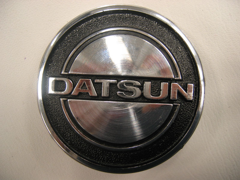

Here is how it turned out. The black was very close I think. Not too shiny, not too flat.
Zak
