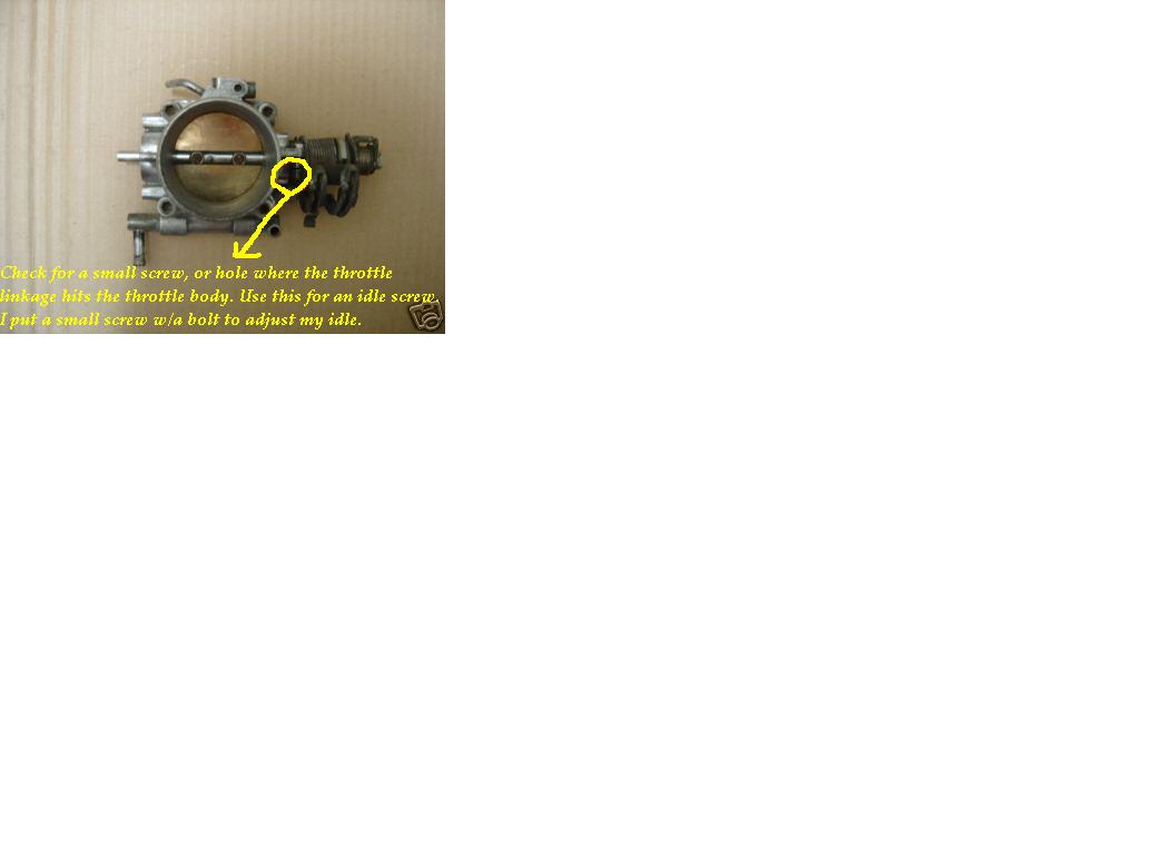

June 24, 200519 yr Author comment_128373 Ok this is a picture of the throttle body that I just got and I dont see an idle speed screw. Help what should I do. Thanks Link to comment https://www.classiczcars.com/forums/topic/16204-throttle-body-upgrade/?&page=2#findComment-128373 Share on other sites More sharing options...
June 24, 200519 yr comment_128380 Check under the throttle linkage, so open the throttle butterfly by hand and check to see where the linkage hits the actual throttle body or plate. you will see a small hole, or even a small screw in there. NOTE - you will have to modify and remove the original linkage on the 240SX and put on the old linkage from your old throttle body. It makes more since when you get a good look at it. Link to comment https://www.classiczcars.com/forums/topic/16204-throttle-body-upgrade/?&page=2#findComment-128380 Share on other sites More sharing options...
June 24, 200519 yr Author comment_128387 You know, I swear I am such a dumb a-s sometimes, I didnt think to even look at that. You are talking about the small screw that has a nut on it :stupid:. Thanks for bearing with me on this. What about those inlet and outlets for the coolant did you just remove those. And what is the best way to modify the linkage just take off the cruise and the throttle and put the 280z one on there or do I have to cut it and rethread it. I found a 34.95 spacer for it on ebay also and just got it yesterday its awesome. I just need to figure out how to shave the intake . Thanks for helping out Link to comment https://www.classiczcars.com/forums/topic/16204-throttle-body-upgrade/?&page=2#findComment-128387 Share on other sites More sharing options...
