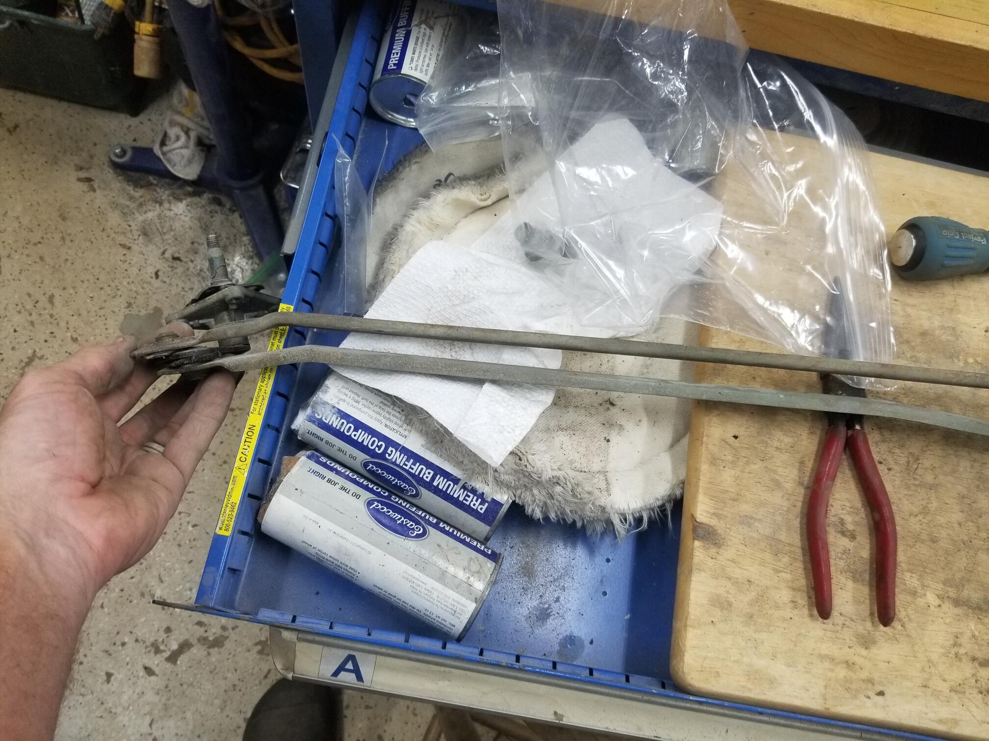

I have 3 sets of wiper mechanisms on the bench. I finally decided I would rebuild them and plate them since I have some other items that need to go to the platers. Since I didn't know of a comprehensive rebuild thread on CZC I thought I would make one I did the break down today So you need to be sure on reasssembly that it looks like this or you're gonna have problems!! I started on the single pivot end The little clips aren't spring steel. The bend open. I might
