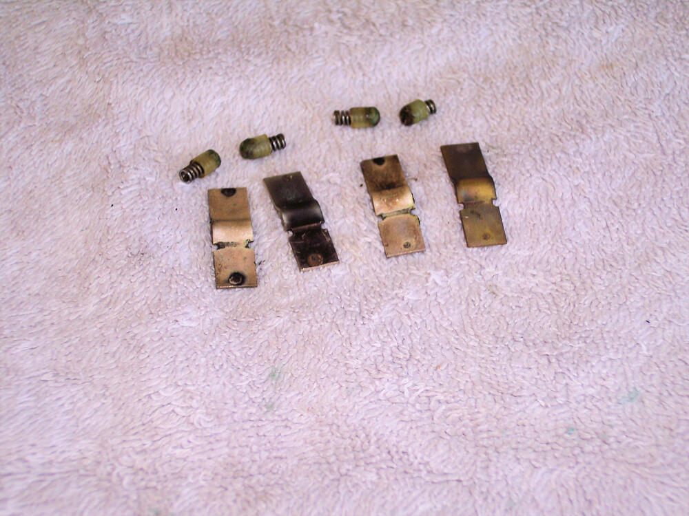

The large gauge black wire on the center post is the high amperage power coming into the light switch from the fuse block, the small gauge black wire on that post is a jumper carrying power to the other side for the wiper switch. Smoke in this area says you have very high resistance either inside the switch or downstream in the wiring or at the lights. If you decide to open up the switch, I recommend you do so on a work bench topped with a soft towel. Tiny bits tend to bounce and run away on a hard surface - ask me how I know. Here's a pic of the small bits inside the switch box - rockers, tiny springs, and nylon "nubbins". You can see heavy carbon buildup on the rockers where they contact the posts on the circuit board. In the pic, one nubbin at the far right is actually melted from heat - it had to be replaced with one from a cannibalized switch.
Did you clean the rockers? How about the contact points in the box, or is that the the nubbins?
You have to clean both the rockers and the contact posts on the circuit board. The springs and nubbins just move the rockers to the various positions to make contact between the rockers and posts.

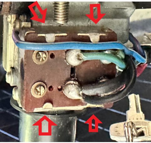

Just received my Headlight Relay Upgrade and the parking light upgrade.  I also opened up one of the boxes on another car that has also had previous heat issues.  It's in worse shape than this one.  This car, the one I initially start this topic about has no melting or exterior signs of heating.  Do we think the resistance is cause by this box, or the heat in the box is a symptom of another problem?    I'm a little hesitant to open this box. You can see in the picture that there is a blue and white wire across the top.  It's pretty tight. Anyway, I'm going to install the relay's and get that part done.
There's no real telling where the issue is located. The blue/white wire across the switch is the washer circuit. You could gently move it to the side so as to open the switch. Installing the relay kit will certainly ease the power load on the switch but you still might be dealing with carboned up contacts inside and a less than optimum circuit.
You could check the switch for shorts to ground or shorts to other circuits.  If it checks out then the very small amperage of the relays probably won't bother it.  You can also check the downstream circuits for shorts also.
Which relay kits did you get?  Both the headlight circuits and the running lights can overheat.

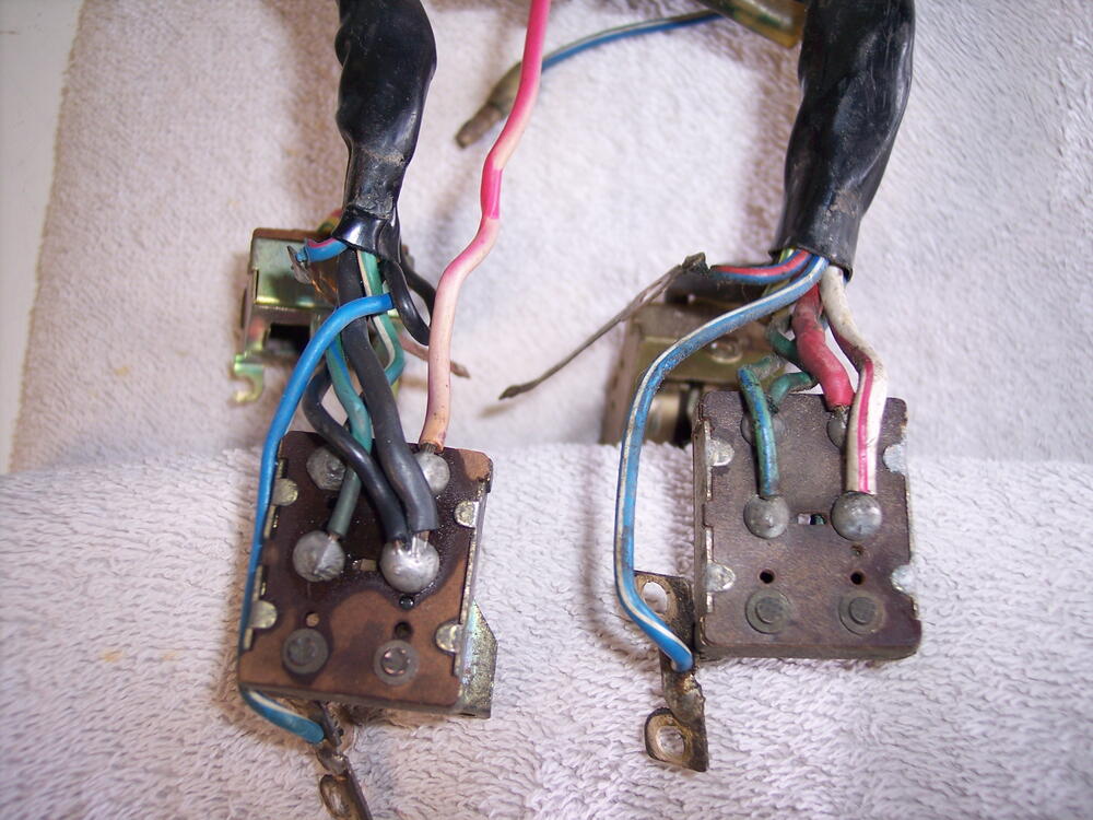

Here's anothe pic that might help a bit. To @Zed Head's point, the switch on the left is the same as yours, on the right is a later design. On your switch the large gauge black wire on the senter post is headlight power in and the faded red/white heavy gauge above it is headlight power out. On the left side is the parking light circuit - solid green wire in the center is power in, the green/white wire above it is power out. The unwired posts at the bottom are for the off positions of the rockers.

Here's anothe pic that might help a bit. To [mention=19298]Zed Head[/mention]'s point, the switch on the left is the same as yours, on the right is a later design. On your switch the large gauge black wire on the senter post is headlight power in and the faded red/white heavy gauge above it is headlight power out. On the left side is the parking light circuit - solid green wire in the center is power in, the green/white wire above it is power out. The unwired posts at the bottom are for the off positions of the rockers.
