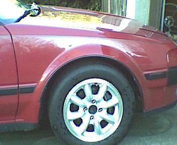

I have a set of 6.5J x 14 RS Watanabe 8-spokes, and they used to be fitted to my old everyday-driver Z. You can see what they looked like on the car here:
6.5j x 14 Watanabe on 73 240Z

Basically, what I'm describing as unsuitable is ( yes ) the amount of wheel rim that 'sticks out'............. On these particular wheels ( his 6J on the front - not the 6.5J on the rear ) the offset is either zero or 'positive'. That suits the smaller Nissan models, but not really the Z. I'm sure they would fit - but they just would not look as good as a wheel that has a bit more 'negative' offset. Its only my opinion, and should not put anyone off making a bid of they want to. Its only a visual consideration.
In my opinion ( and take that for what you will ) the R.S.Watanabe 8-spoke ( "Hachi-Spo" ) design looks better on an early Z when it starts getting a little wider than 6J. Watanabe made a bewildering amount of sizes and offsets in this design over the years ( yes - they started making wheels in the Sixties ) and have altered the design slightly for some sizes down the years too. I think a nice size for the early Z is 7J or 7.5J - and 15 inch is probably easier to find tyres for than 14 inch these days. 8J x 14 & 15 look tough, and once you get up to these sizes the 'negative offset' starts becoming more apparent. They really do look more deeply 'dished' - as we used to say.
