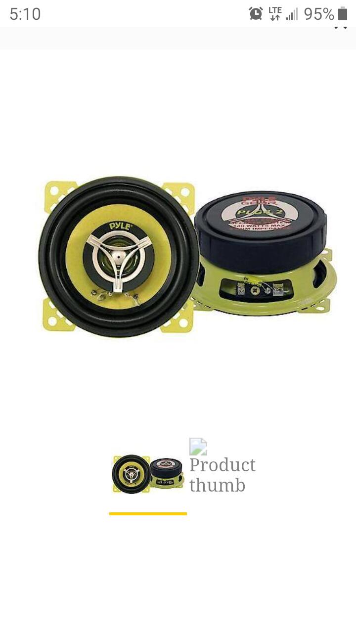

I am looking for a pair of 4” speakers for the spot below the quarter panel windows on the 78 280z anyone have a suggestion for what they have or like for that spot. I am not sure how deep it is and also looks like I can’t have a tweeter that extends past flush or it would hit the panel cover

What did you decide?  I need to put new speaker there too.  Those Pyles are on Amazon for $31.   Crutchfiield has a large selection too.
Cliff any mods to make that speak fit?   How is the sound?  I’m tired to removing and install8ng things twice.  I just pulled those panels off and plan to put speakers in there and never pull it again.

From what I remember they bolted right up, no issues. There's a bracket that holds them.

I put in the speakers I got and here are some pictures. I also took pics of what I assume are OEM speakers.  The back side of the one I pulled is the first picture. They screwed right in no issues at all66A19CDA-7DE9-4805-AB35-5EC6F7712095.jpeg2CB3D2FD-7DC7-404A-B05D-4F0D5279F097.jpegB02CCC3A-3856-41D4-989D-F0759FDF0D0D.jpegFC21F743-4803-49C0-BF0C-F3C1F49B1A14.jpeg
